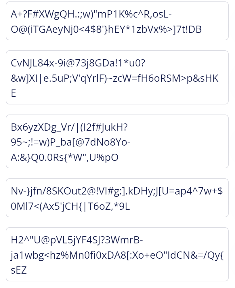

I have strings containing passwords that contain special characters that are splitting up across multiple lines when being displayed in multiline input elements in a RG.
Assume it’s because of particular special characters that cause the line break (like in the examples above) showing the break after the ? symbol. Is there a way to keep this from happening so that the string flows to the end of the line before it continues on the next line?

the multiline stretches vertically when the string is longer than the width. And it provides enough space for the content to fit in vertically But the text still separates. I notice is only does it with content that has special characters in it. Not when there is numbers or alpha characters. And as the image shows below - not for all special characters.
