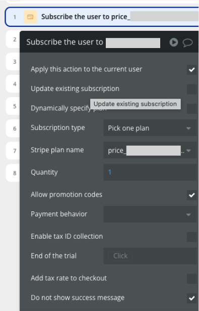

Hey! Is anyone else experiencing the below for the ‘Subscribe the user to {price}’ workflow action for the Stripe plugin from Bubble? :backhand_index_pointing_down:
Screenshot 2025-08-18 at 3.38.32 PM
As a result of this error, the subsequent workflow actions are not working to create the subscription and add it to the users’ account. A few new customers were quite confused by this and nearly checked out for a second time.
I made a few privacy updates a few days ago, but I don’t think this is the issue because the Stripe price is being directly input into the plugin action instead from a db table. This also isn’t work for dynamically selected plans too. See below:
Any advice on how to solve this would be really appreciated :).
