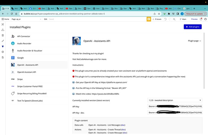

I fixed the json safe and the error is still occurring. Here are the screenshots of the plug in that I am using along with my api keys attached to it. I do not have an api connector for this. In the tutorial there was nothing said about using the api connector. Do I need to do that?
There’s a lot of topic on OpenAI that could help you to do it in API Connector. I,ve checked the plugin “code” (you could also do that and check how it’s set because it’s free and it’s using API Connector…) and you cannot encode as json-safe the thread ID. And the content part could be encoded but you will need to remove the doublequotes that the encode as json-safe add at the beginning and end because the call already include them. If you set it yourself, you will be able to remove it from the API Connector and at this moment use arbitrary text:encode as json-safe for the content field
