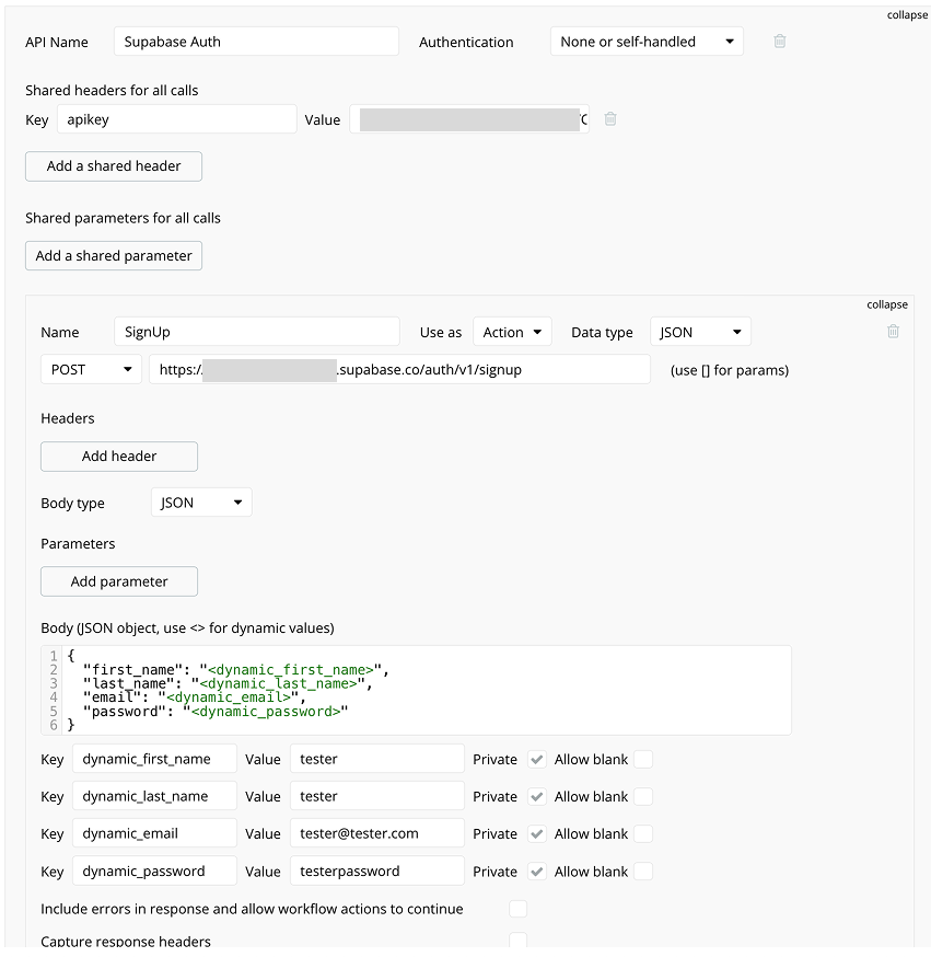

Thanks for a comprehensive post. I tried following the steps that are relevant to me. I’m trying to connect Bubble and Supabase too. Starting out with trying to get signing up new users to work with a POST call.

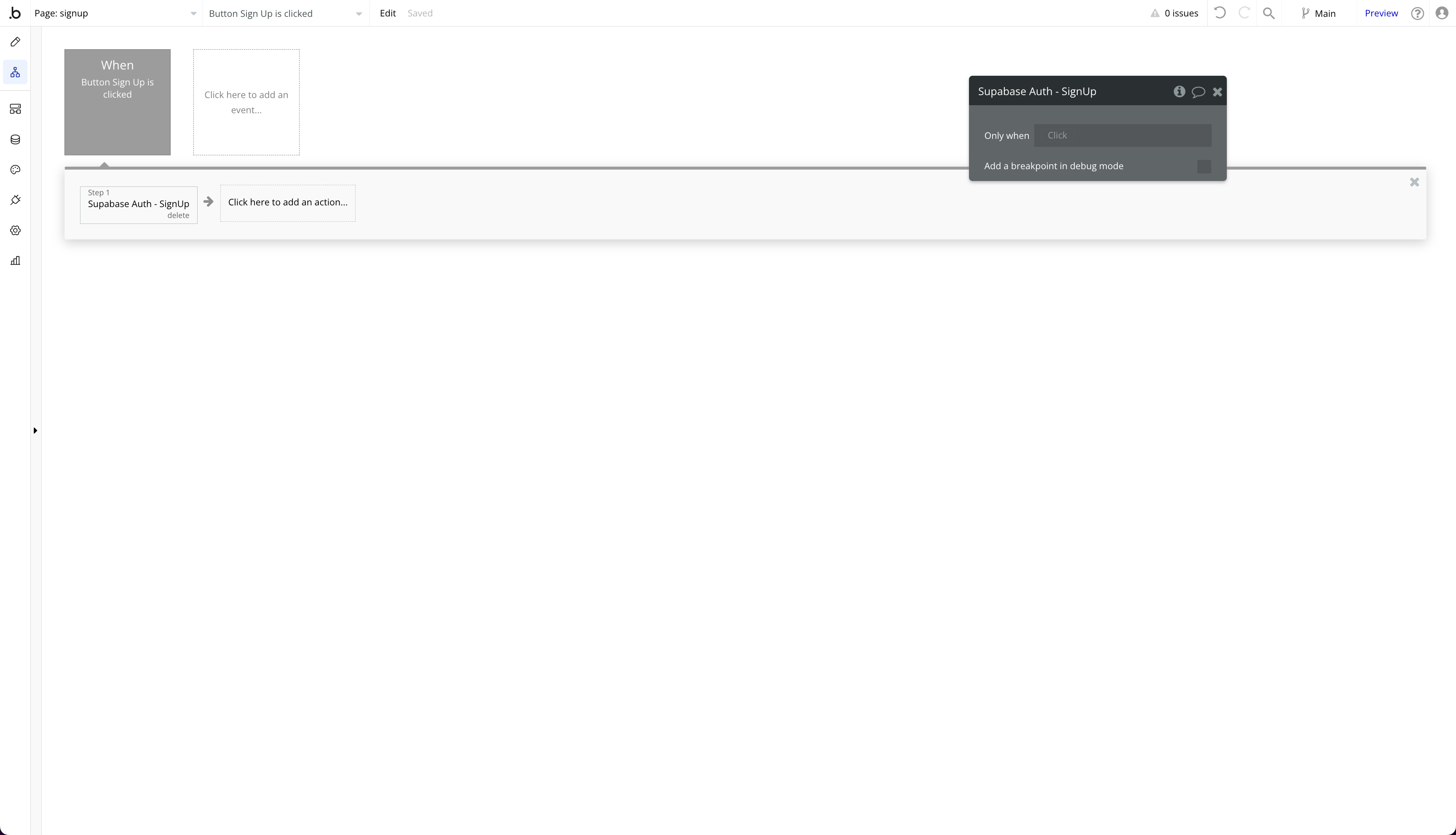

I think I am getting the setup in API-Connector right but when I’m about to set up a workflow connected to a sign up button I’m just lost. My assumption was that I should be able to map against the specified inputs in the API call here.
Any guidance here would be appreciated.
Just use the normal button for a sign up, run that sign up API connection and you will be getting response pack with id and email you can store it. That id is the unique ID of that user, which you can reference it with other tables if you plan to, otherwise that will be also be seen in your auth.users table.
You will be needing a JWt token, which you can get by making one more call of login by sending the email password which shall return you a JWT token which is also the user session token. you can store it as way you like
