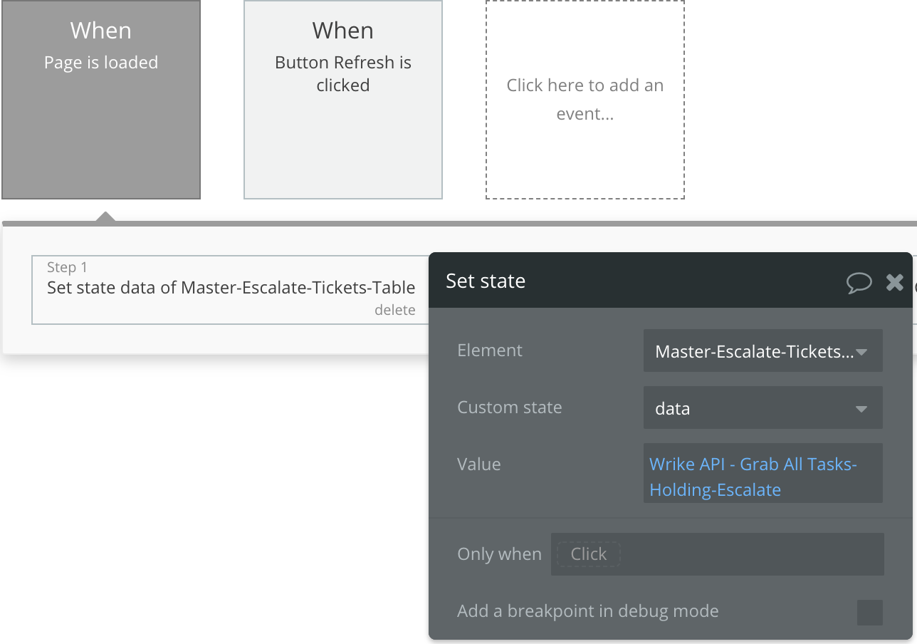

First, I placed my Wrike API data into a Custom State on Page Load.
Note: When this data is pulled from Wrike on page load, it is cached, meaning it does not refresh unless there is a fresh page reload - A way Bubble can speed things up by reducing the amount of data traffic. So, I had to find a way to “bust the cache” as @mishav mentioned in the post above.
For testing purposes, in my app, I created a manual REFRESH button. When clicked, I wanted it to grab fresh Wrike data without having to do a page reload. This would then pick up the fact that if a task no longer existed in Wrike, it would be removed from my app immediately!
To do this, I plopped down a Refresh button, and then the following workflows on said button:
First workflow step on Refresh button: CLEAR the Custom State that used to have my Wrike API data in it.
Second workflow step: Exact same as the page load. See screenshots below.
By “clearing” the custom state before setting my Custom State again, it was finally able to refresh the data without requiring a page reload. I can go to Wrike, change the status of my task, click “Refresh” in my Bubble app, and it works!

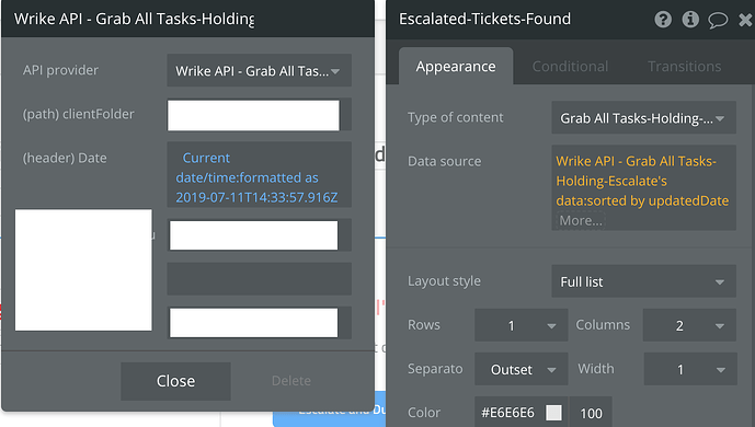

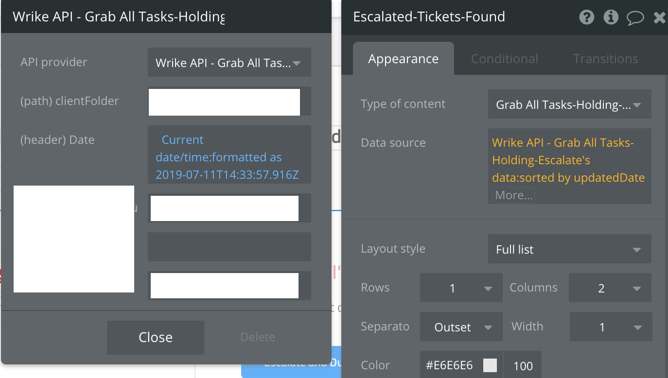

Update to this post - There’s a MUCH easier way to approach “busting the cache” that doesn’t even involve custom states.
Backstory: The method above was no longer working with new workflows I was creating… So, I sent in a Bug ticket and got great help from Bubble.

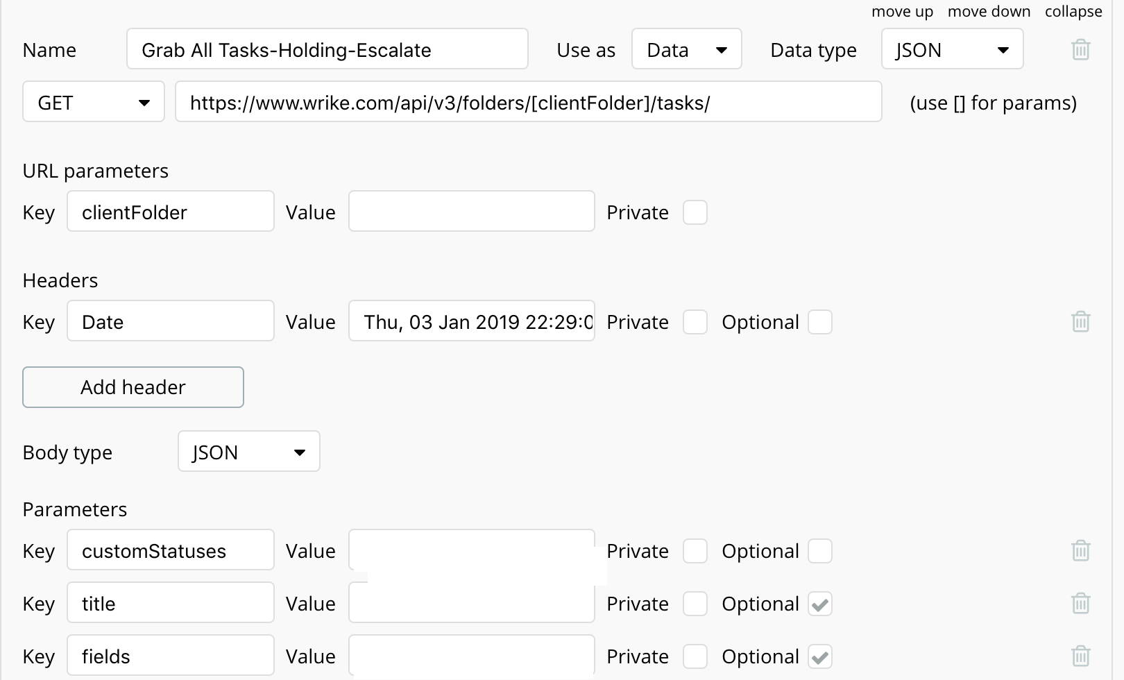

The new solution to refresh data from a 3rd party API without a page refresh: Add a “Date” header to your API call as seen in the picture below - Set the current date time w/ Bubble. Notice I did the simplified ISO. That’s so it gets down to the second vs. the minute.
Adding “Date” header now tells the API to grab data for that very second - Which means I get a fresh crop of data!

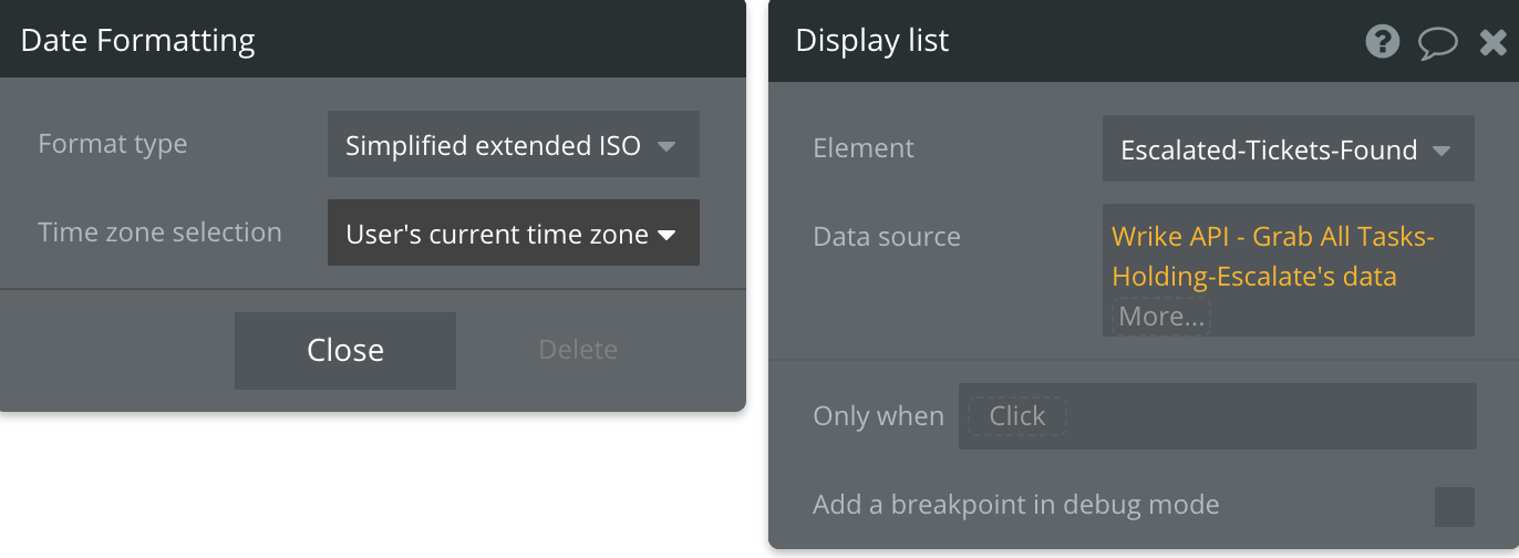

So, the above solution with the custom states and all of that is overkill - I wouldn’t recommend it anymore. I am now displaying the list of data right in my Repeating Group. Much much easier.
Enjoy!
OLD WAY
NEW WAY

Well, I’m not sure how the SQL connector works, but maybe showing you all of the pieces of what I did will help get you to the next step:
  1. In the API Plugin, I added in a “Date” header into my API call. Make sure to uncheck Private - You want to be able to access this in the Bubble editor.
  2. Next, when I made my call to the API again, you’ll notice that there is a (header) Date field… Which I then filled with the Current date and time. See screenshot.

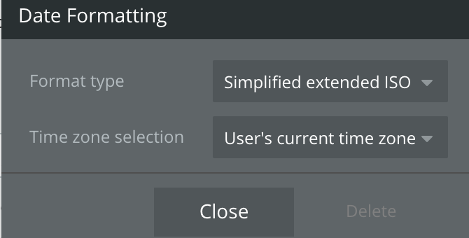

  3. Finally, take a look at the formatting - I formatted the Current date and time to be ISO. See screenshot.
Sorry I can’t get deeper into specifics into your individual case with the SQL Connector plugin - But hopefully this helps. The methodology above has worked for me for the past few months.

Correct me if I’m wrong : I need to leave the repeating group data source blank, but only pushing my API data with a date header and using a worklow when needed ?
I don’t - When the page loads, the repeating group has the data source in it. I know it’s odd because all through the forum are posts saying the data source has to be blank and that the “Display list” doesn’t refresh. In my case, keeping the data source on load worked just fine. Maybe the “Date” field being dynamically different each time a call is made has something to do with it?
Thanks @w.fly
For me, it finally turned out that I just have to re-display the list in a workflow, with or withoud a date header in the source API apparently.
I was pretty sure I havetested this before but apprently not…

Yea, it still works. Make sure the format of the date is correct and that it’s in the header. Here’s what the call looks like on my end. Hope this helps.
Screen Shot 2020-07-31 at 9.04.05 AM
Screen Shot 2020-07-31 at 9.04.13 AM
