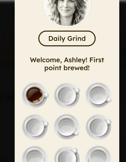

I have a loyalty card that pretty much runs on an option set. Points, color for each level, message blurb, etc.

Using Option Sets with rich attributes like color, images, and message blurbs is such a smart approach especially for something like a loyalty card where consistency and performance really matter. I love how you’re leveraging them beyond just basic labels turning them into dynamic, design-friendly data blocks. Super efficient.
Thanks for sharing that example really insightful. Curious, do you ever nest option sets or use them for user-facing logic as well?
