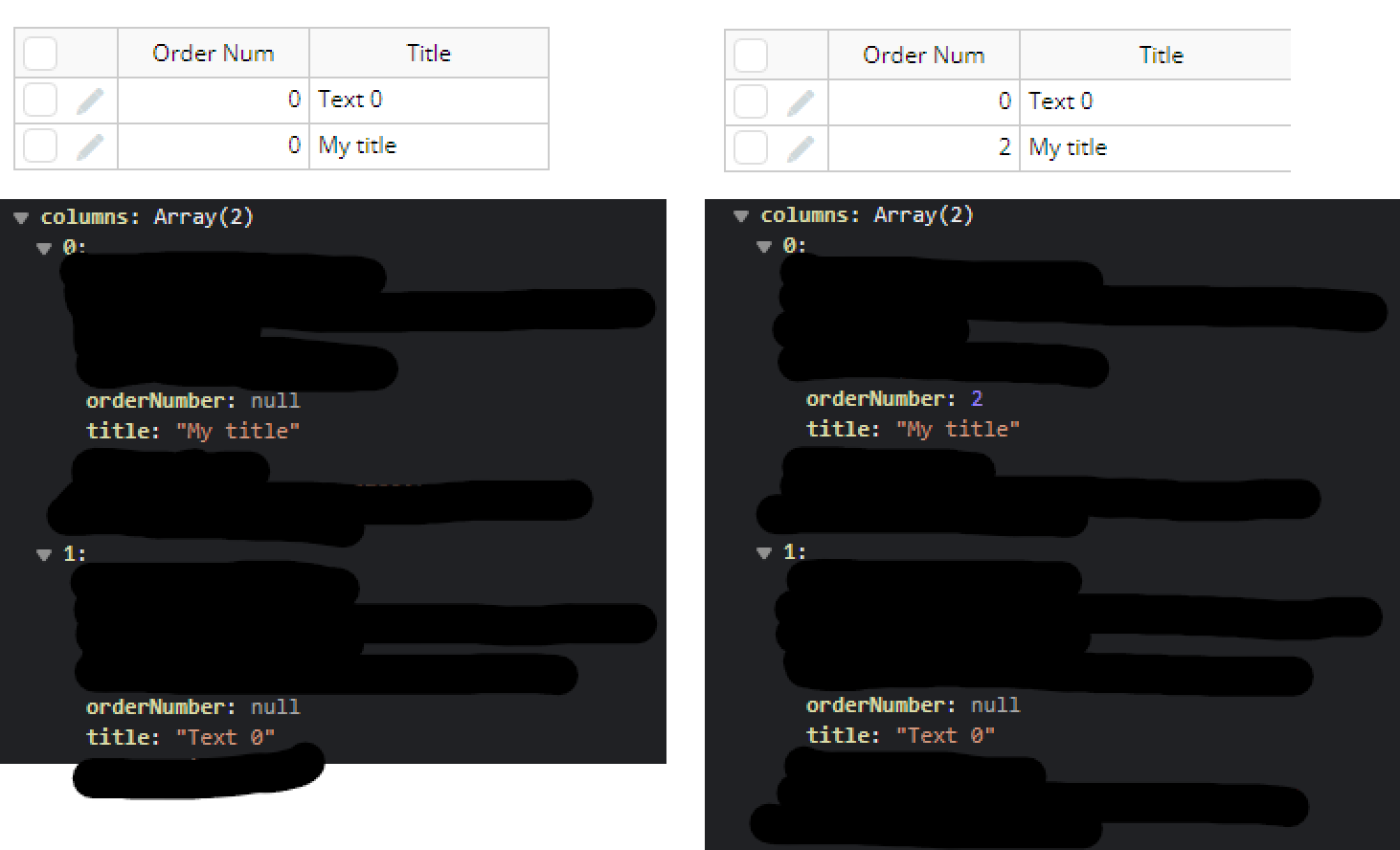

I have a list of Things that I am trying to fetch in a Server Script using Thing.get(). It seems that when the Thing’s Order Num (a Number) Field contains a zero value, the .get() method returns null instead.
This behaviour seems isolated to Number fields, as the string “0” returns correctly, but the number 0 returns null.

Yes, and how does a Promise affect whether the response returns a null when it should return 0?
As you can see in my screenshots, I have no issue printing orderNumber for the Thing titled “my title” using await Thing.get("orderNumber"). So I fail to understand the relevance of your point.

I tried it myself. It looks like it is indeed a bug. You should go on and send a bug report.

Current workaround to the “Number 0 to Null” issue is to replace all Number fields with String fields, and casting to Numbers when needed. The String 0 returns correctly using Thing.get(prop). String versions of digits seem to sort correctly too, so need to cast to number when sorting.
