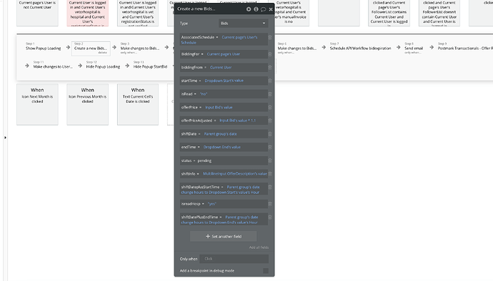

I have a booking app. The user selects a date on the calendar, and a pop up comes up to confirm the booking.
The date in this pop up are stored as “date” in the Parent group, which the user sees correctly regardless of the time zone they’re in.

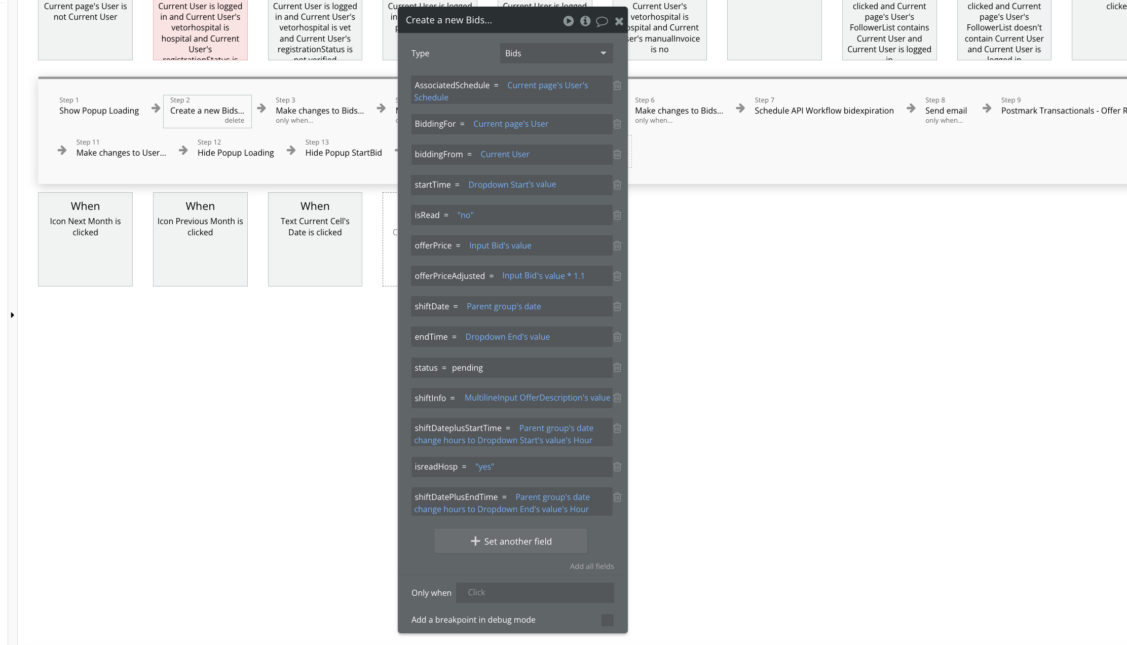

Now when the booking is actually made, if the user is in a timezone where the day is different (Asia), shiftDate is being saved as the date before.
I’ve tried to enter it as Parent groups date:formatted as (time zone I want), but then it saves the date as a text instead, which I can’t use

I’m actually already using TopCal plugin. The issue is that to the user, it appears that the date is correct, but when the user’s timezone (if in a far off location like Asia) and Bubble’s time zones are apart enough, when the date is saved to the database it records it as a day off.
My goal is to have the app be independent of time zones. If a shift at a hospital starts on 8/15 at 8AM, that’s what it needs to say for every user regardless of where they are.

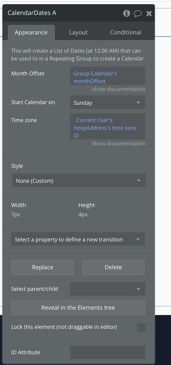

I think I’ve managed a partial fix now by setting the time zone to the hospital’s address when the hospital posts a shift. This now lists the shift date correctly, but I still fear users will still see the wrong shift dates somehow.

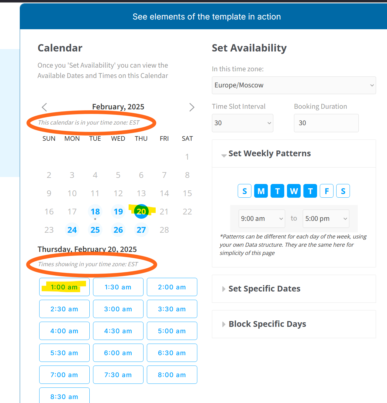

Hey @ramzizi, this is fully doable with TopCal but as you have noticed there are a couple things to do if you want Dates/Times to always be showing in the timezone of the location of the hospital, there are two main things you must do.
  1. Always set the time zone id in TopCal elements to be the time zone id of the hospital (looks like you are)
  2. For text elements always use the :formatted as for Date/Times and be sure to set the time zone id to the hospital’s

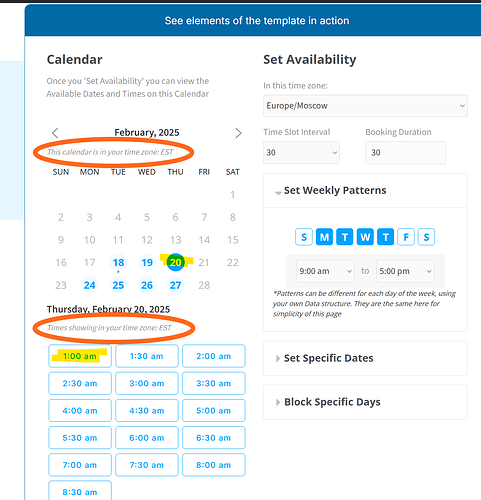

As an example this homepage, screenshot below, lets you set availability in a specific time zone, and then displays the times back in your current browser’s time zone. To change it to the function how you want with showing in the target time zone, you would make sure the Calendar and Times (highlighted) are the target time zone instead of current users.

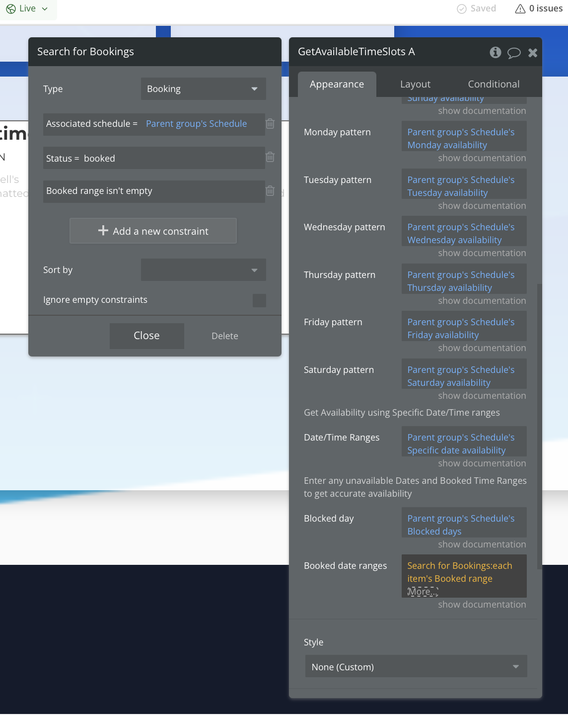

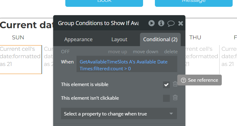

I’m running into another issue now. On the home page for both doctors and hospitals I have a calendar which displays confirmed bookings using your GetAvailableTimeSlots element like this:
The bookings are not showing if the user is in a far off time zone. How would you suggest addressing that? I do have a user that’s creating bookings at hospitals in America and she lives in England.
In this case though she could be booking multiple different hospitals across different time zones.
I realize it’s getting complicated now - do you book private sessions to help me through this?

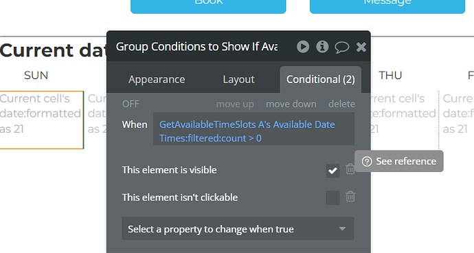

The bookings are not showing - where exactly are they not showing that they should be?
A couple ideas
  • Were they made when the calendar / time zones were not lining up as expected? Old data could be a likely reason since the recent change from this thread
  • If they are not showing based on that second screenshot, I am curious if the BookedDate is the culprit is it a Date or Text field in the database?. If it is a Date, is it the start time of the Booking? If yes, this will not line up exactly with a Start Date of a say a Calendar’s cell which is usually 12am. You would want to filter based on the entirety of that Day in a calendar, not a specific point in time

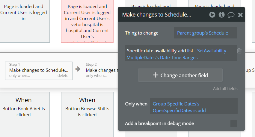

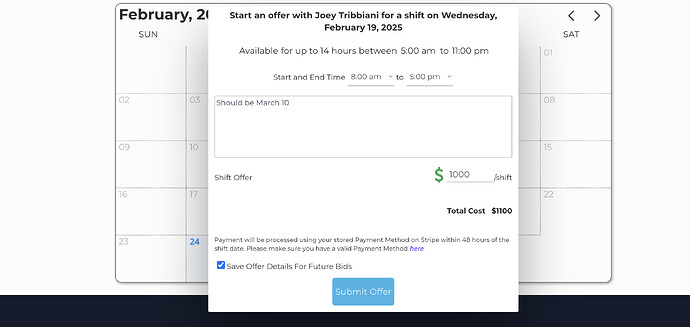

Thanks for your advice. I’m still struggling to figure this out, so maybe I can show you one of my more basic issues.

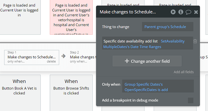

I have a user that sets their availability for booking on a calendar. They pick the dates using date/time picker. It seems like as you suggested, it saves the date ranges in UTC.
Unfortunately my app is very entrenched in using date ranges to display availability. When a user in Asia selects March 3 8am-5pm, it’s getting saved in UTC when ends up saving as something like [“March 2, 2025 3:00pm”, “March 3,2025 12:00am”]
This displays correctly on the vet’s calendar when in Asia. But incorrectly for the hospital. And I just had a real world hospital user who was in a separate time zone from their hospital, so I’m not sure how to display the correct time if I don’t know what time zone the hospital user is going to be in.

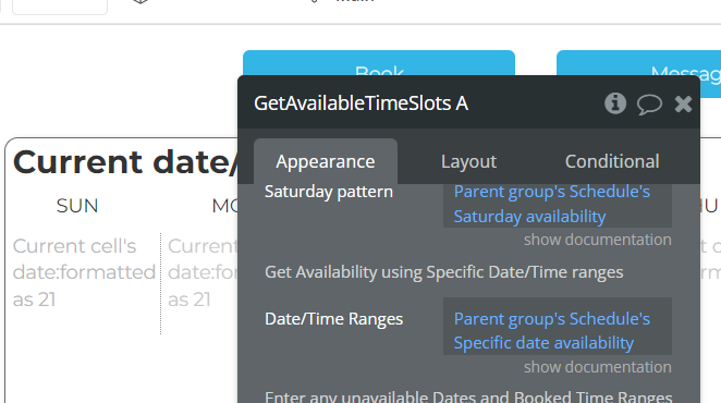

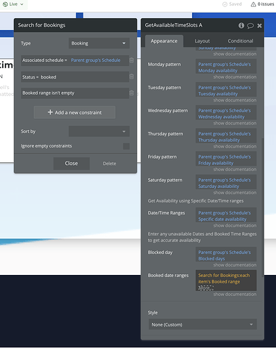

The available dates are displayed according to this:
Just keep EVERYTHING in UTC and you can’t go wrong.
I’ve spent the last day trying to convert everything to UTC. It’s turning into quite an ordeal, I have hundreds of workflows and text elements that need to be reconfigured. This is turning into a crazy amount of work and I’m creating more bugs than I had initially :sob:
I think the issue is in how the plugin requires the day of week pattern for setting up available time slots. It looks to be requiring a field value that is a date range, so if the date range is supplied as Sunday Feb 23 from 9PM - 10PM in NYC, it will look as if it is Monday Feb 24 from 9AM - 10AM in Asia timezone, which when put into the Sunday Pattern field value, will end up with the wrong time slots since the plugin likely parses the date range for the day of the week number. This will result in issues with time zones and daylight savings. I could be wrong though as I do not know 100% for sure how the plugin functions or what the field values are supposed to be.
If I am correct than @ramzizi you may want to adjust the data structure you use for storing the availability ranges, so that instead of saving them as it seems they are as separate ranges for separate days of the week, you may store them all in one field as a list of ranges and then provide that single field as the pattern value for each day of week with filters to extract the day of week number from the patterns date range values…this will still be difficult though if the date ranges span hours that will in other timezones change the day of week number (I’m thinking start of range versus the end of range as being different day of week numbers).

I just released the free template that uses my plugin.
In the video below I demonstrate a booking and how the users current timezone is detected and populated by default, but while selecting their desired timeslot, they can choose to change their timezone and the selected date and available timeslots displays are updated to reflect that newly selected timezone.
In the video I also demonstrate the day light savings aware. In my timezone, Asia/Bangkok, we do not follow daylight savings. In NYC it falls around March 9th this year, so I select March 7 and then March 14 to demonstrate the difference in the America/New_York timezone due to the day light savings change.

I will update this page shortly to let you change the Calendar and Time buttons time zones so you can see setting in a single time zone and seeing it back in that same time zone regardless where your browser says you are.
