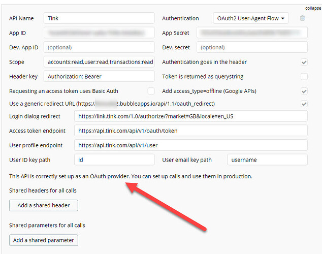

sorry for the delay . Here is how i managed to connect Tink API.
Thanks for sharing your workflow. Unfortunately when redirected back to bubble I get this message “API Connector error: the Oauth2 API Tink is not configured properly - Received error from api” which is strange as the token is exchange and the credential ID is correctly input into the url.
Could you share a printscreen of your Call ?
Sure
I am using Tink in live mode, so no test need on url
It looks ok! Please share a printscreen of App Setting in Tink

here you go
Managed to get it working! the url I entered for the user profile endpoint was missing the “i” in /api/

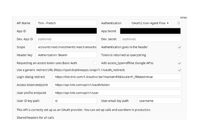

I am still having issues with authentication & authorization step. I don’t really know what to do after having set up the oAuth2 User-agent flow according to what you have done.
  1. I have set up the Oauth2 User agent flow according to the first picture below
  2. I have build a user flow, where the user logs in to my app, then clicks on a link taking it to the Tink page (i.e. the tink-link with my clientID and redirect URI, which is a blank page on my app)
  3. I run the flow as a user, logging myself in at the app, navigating to the Tink-page, entering my bank details and get redirect back to the bubble app with a account_verification_report_id in the URL

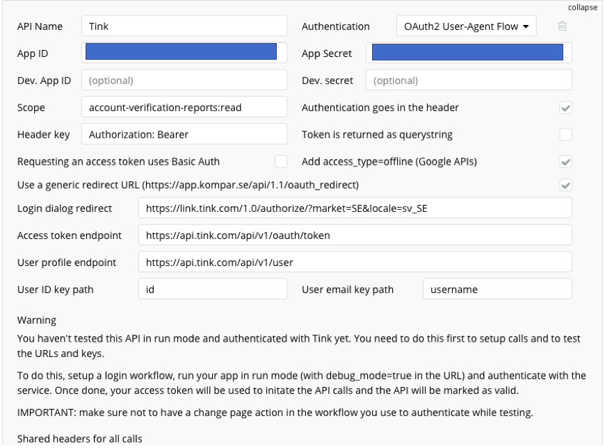

  4. I then enter the following details (see picture 2) in an API call, but as soon as I click on “initiate call” I get the following error message. “There was an issue setting up your call. Raw response for the API. Status code 401. Unauthorized”.
  5. I tried to initiate the call again after having removed the account_verification_report_id from the get command (i.e. running it on https://api.tink.com/api/v1/account-verification-reports/) , though I get the following error message in that case: “There was an issue setting up your call. Raw response for the API Status code 405 Method Not Allowed”
Any ideas on what I should do differently?
Hi,
It looks like the OAuth2 flow has not been initialised yet.
The login workflow needs to be for example;
1.User clicks login button-----> sign up/ login with social network-----> Select the Tink Api from the dropdown
  1. to initialise the OAuth2 flow you need to be in debug mode so make sure ?debug_mode=true is on the end of your URL.
URL
  1. Now click the element in your app that initiates the tink login workflow on your app----> verify with tink-----> redirects you back to you app with a success message
success
  1. Now in the api connector you should no longer have the warning message at the bottom
  1. Now your get response should be authorised and the information will be sent back.
Hope it works! let me know if not.
