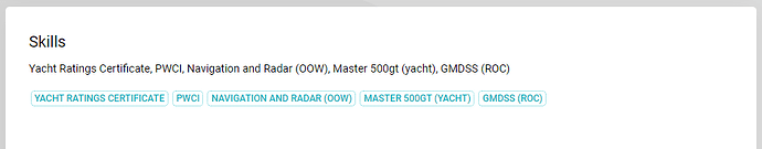

I was searching around how to make my boring output look a little prettier. It was basically a list of things that outputted like this:
Yacht Ratings Certificate, PWCI, Navigation and Radar (OOW), Master 500gt (yacht), GMDSS (ROC)
I liked the thought of adding each list item to a tag display, but I couldn’t really find what I wanted here in the forum so I created something myself. I thought I would take a little time to jot down how I did this, and who knows, it might help someone else looking for the same thing too.

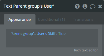

Initial (boring) list:
skill4
skill2

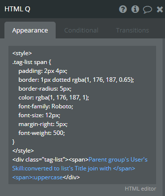

I knew I needed to insert some <div>'s and <span>'s for styling. Unfortunately, text elements don’t allow for these to be added /replaced. I replaced the text element with an HTML element. Here’s what I managed to output. Much better than the original text element could manage.
HTML element
skill5
skill3
The trick is to:
  • Add a div before the dynamic data
  • Use “join with” on the dynamic data using an end and start span
  • Add a closing div after the dynamic data
By the way, I don’t normally have css on-page - it’s just for this post. Hopefully this helps someone :slight_smile:
FYI, I changed the styling code slightly so it wraps the tags correctly:
.tag-list span {
    padding: 2px 4px;
    border: 1px dotted rgba(1, 176, 187, 0.65);
    border-radius: 5px;
    color: rgba(1, 176, 187, 1);
    font-family: Roboto;
    font-size: 12px;
    margin: 0 5px 10px 0;
    font-weight: 500;
    display: inline-block;
    word-wrap: break-word;
    white-space: normal;
