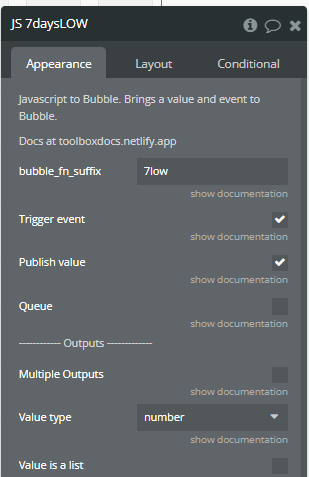

This part is done. Actually I have three variables that I pass this way back to app. Each has these setting. Anything else that I might do wrong?
Thanks,
Make sure that any actions requiring the processed values, run in the J2B Element’s trigger event WF or after the event has triggered.
