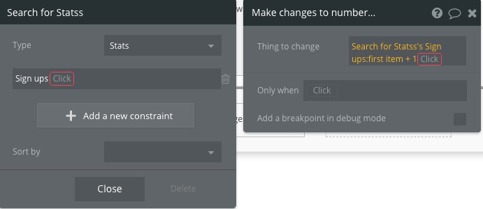

I’ve created a Data type called stats where I want to track different metrics such as signups. My thinking was just to track the number of clicks on the “Sign up” button for example but I can’t get it to work. It’s possible to do it by creating a new thing each time with a value of 1, but I would prefer to change the thing so that the value of 1 is changed to 2 etc. etc.
Is this possible? I’ve included the screenshot below of what I’m currently trying but it’s producing an error.
Thanks so much for this. Makes total sense. Although I have now tried it but it also doesn’t work for me. I take it the field should be of type “number”?
Great, thanks for that. I’ve removed the search for stats. Still not working. When you say to make sure the thing to change doesn’t have a +1, what does this mean?

I think that is how you have set it up in your database, if not maybe you can let me know how you are structuring your data and I can show you more exact.
I’m assuming you have a type “Stats” with a sub type “Sign ups” (as a number) right?

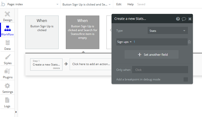

Ok, it seems like “Create if the thing doesn’t exist is no” and there is no option to turn this on from the workflow, there used to be an option. @Emmanuel, was this turned off for some reason?
So here are some screenshots to work around it. You will have to do some kind of initial set up of the number, here are some screenshots to help you out.
Create a workflow that only runs when the first item is empty.

I have it setup exactly as you have and I’ve also got the Database structured in the same way, although it still doesn’t work. I had thought the same about creating the first item(e.g. 1) so I did this manually and hoped it could just be updated from there, but for some reason I just can’t get this working.
