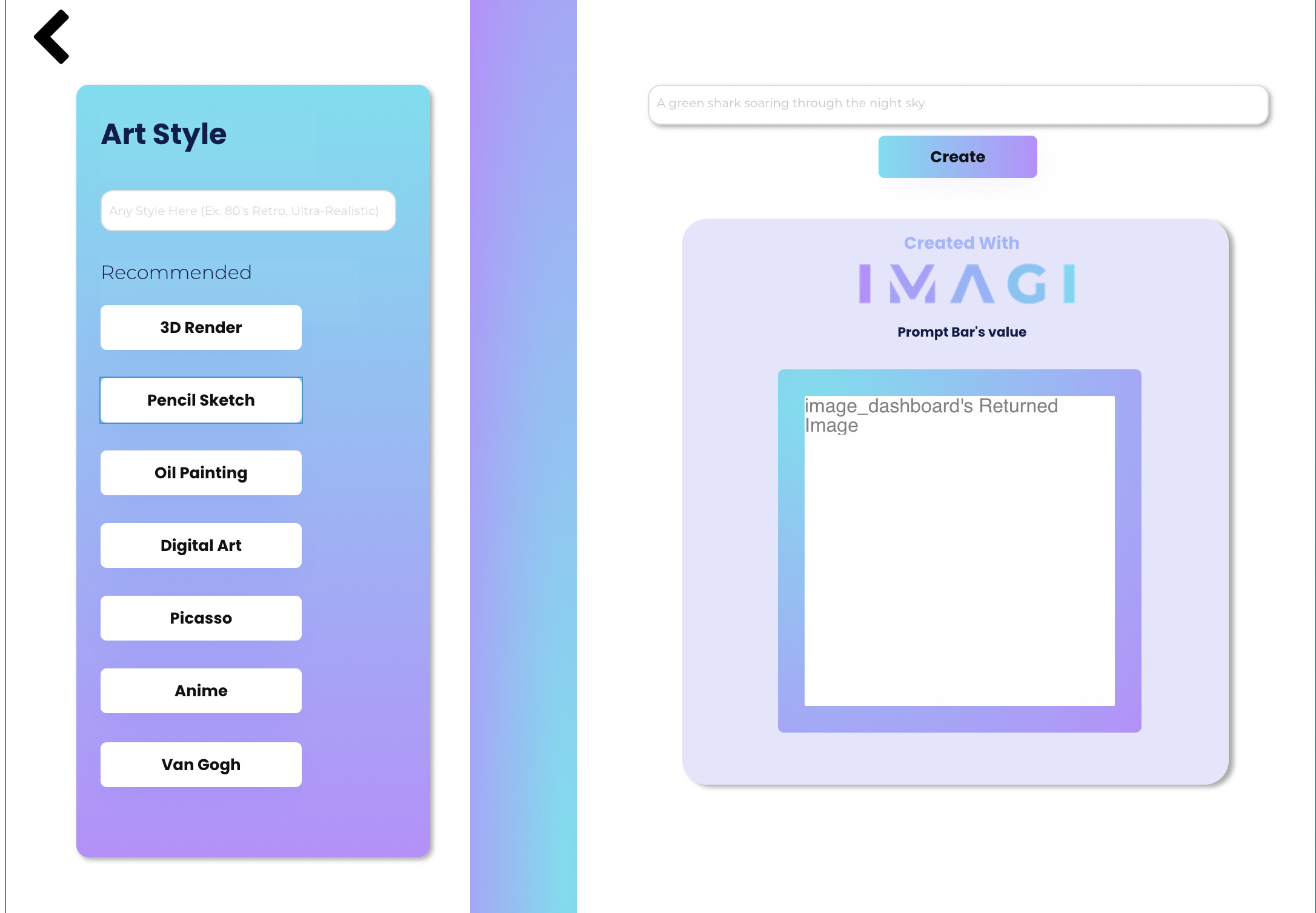

In the photo above there are 2 sections (the art style, and the prompt text box on the right side). What I am trying to do is the following. If the user clicks 3d Render on the left side for example, then the word 3d render will be added to the prompt text box on the right side, but I want the text to be invisible so that when the user types in the prompt text box they don’t see the text already there. For example, if a user clicks “3d render” and in the prompt text types “a green boat” then the prompt will have the value “a green boat 3d render” but the user only sees the text “a green boat”

Ok. Im a bit new to custom states so i’m not exactly sure how this works but let me know if this is right. So I save the left side’s text in a custom state and then append it to the right side’s text value, and it will be invisible? I tried doing something like that without custom state but the text was still visible. Im a little confused but thanks for the help

I’m using Dalle and want to make the prompt as simple as possible. So by splitting it into different categories, it will make an easier UI. So users only type something simple, but will get an advanced generation because of the preset options. That’s why I want it to be invisible so it will be as simple as possible
