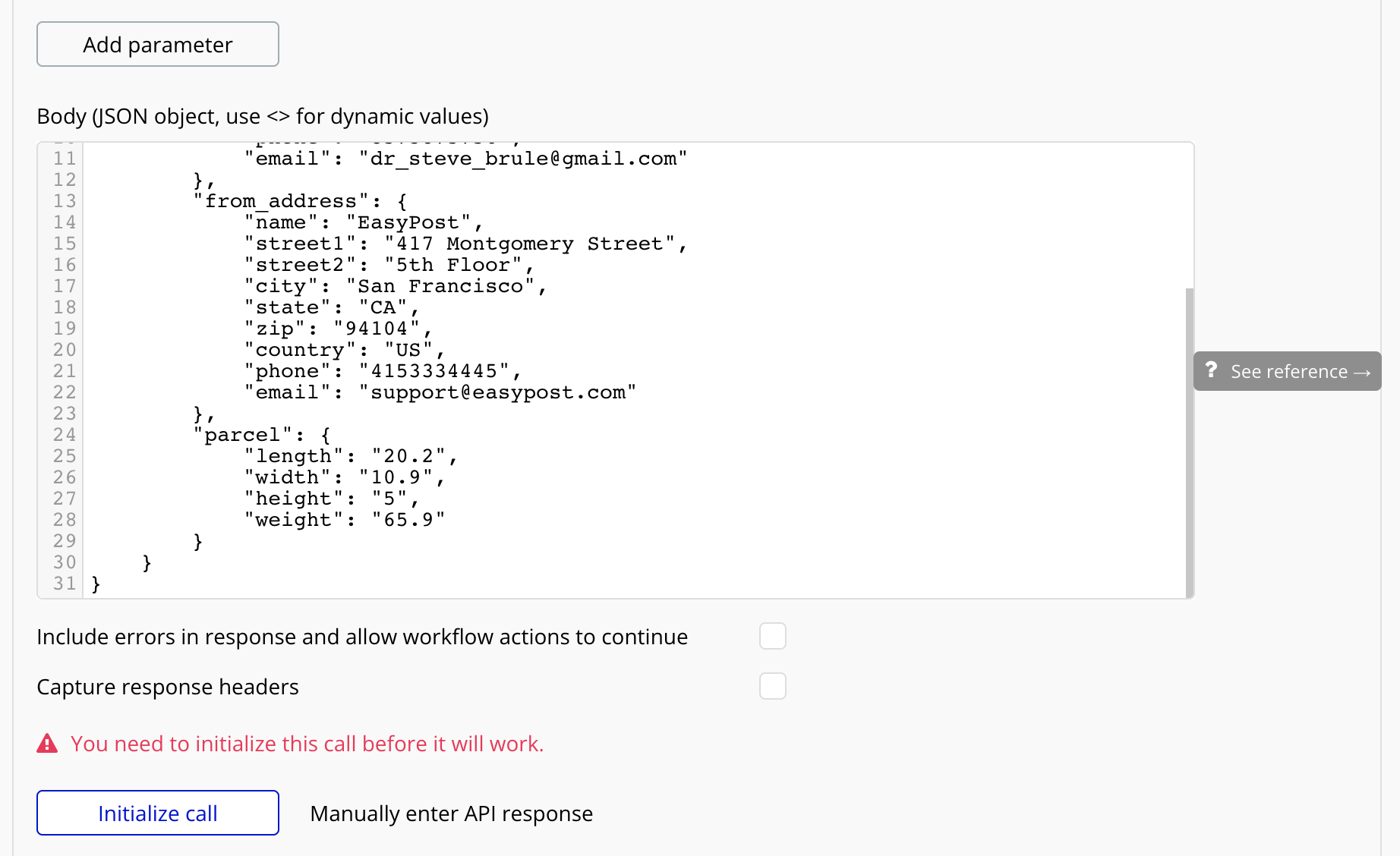

I’m trying to connect the EasyPost API using the Bubble.io API connector, and I keep getting a specific error message. I’ve contacted the EasyPost API developers and they don’t see any obvious errors, but I can’t get it to work. I’ll attach some images of how I’ve configured the call, and an image of the error message I’m getting. Anyone have any ideas?

The length, width, height, and weight need to have the quotations marks removed from them in the “parcel” object. They are supposed to be float (number) and not a string. If that alone doesn’t fix it then maybe add a decimal and zero to the end of the height to make 5.0.
Crazily enough, this didn’t do it. I removed the quotations to make these strings, and I added a decimal and a zero to make the floats consistent.
Very strange…
Let me know if you have any other ideas! I’d love to hear what you think!
I’ll also copy out the JSON code here so it’s easier to see:
