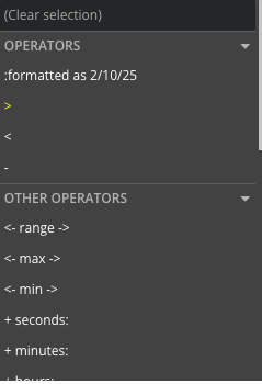

How do i write an expression where only when the Current time of a thing is within 3 months of the created time of a thing. (cannot be greater than 3 months). It must only be from the Current time and the last time the thing was created. Below are all the operators that are visible. There is no >= or <= or +*/. The expression bellow doesn’t appear to be working. I only want it to calculate within 3 months or less. Nothing pass 3 months.

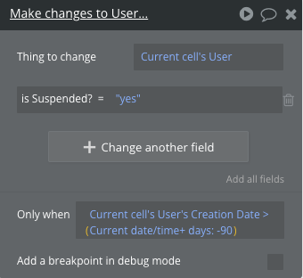

If you want this behavior just one condition is enough and your condition should be:
Current cell’s Thing's Created Date > (Current date/time +days -90)

This:
evaluates to True if Current Cell's thing's created date is for example January 1, 2025 and Current Date/time is today. Because Current Date-90 is November 13, 2024 and January 1, 2025 is greater than November 13, 2024 which means January 1, 2025 > November 13, 2024 evaluates to true.

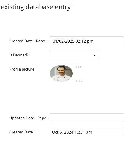

Thank you, it works with the default Creation field! I think the problems lies with the extra “created field” that I added. It wasn’t evaluating correctly. Why would it work with just the default “Created Date” field(bottom) and not work with the added “Created field” (top)?
This final result it evaluating correctly, but I need an explanation why it’s not evaluating the other “created date”?
I think with the additional “created date”, using “+days:-90” doesn’t work. That’s why I think wasn’t evaluating correctly. For some reason it doesn’t seem to be evaluating the “+days:-90”.

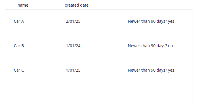

It is working with other fields as well. See the demo below. I have added a field that is a date and evaluated the same thing to understand if the thing’s that new field’s value is newer than 90 days or not. It works. I am pretty sure you have a different problem in your logic.
In this example, the created date is a field I have added later, not a built-in field.
