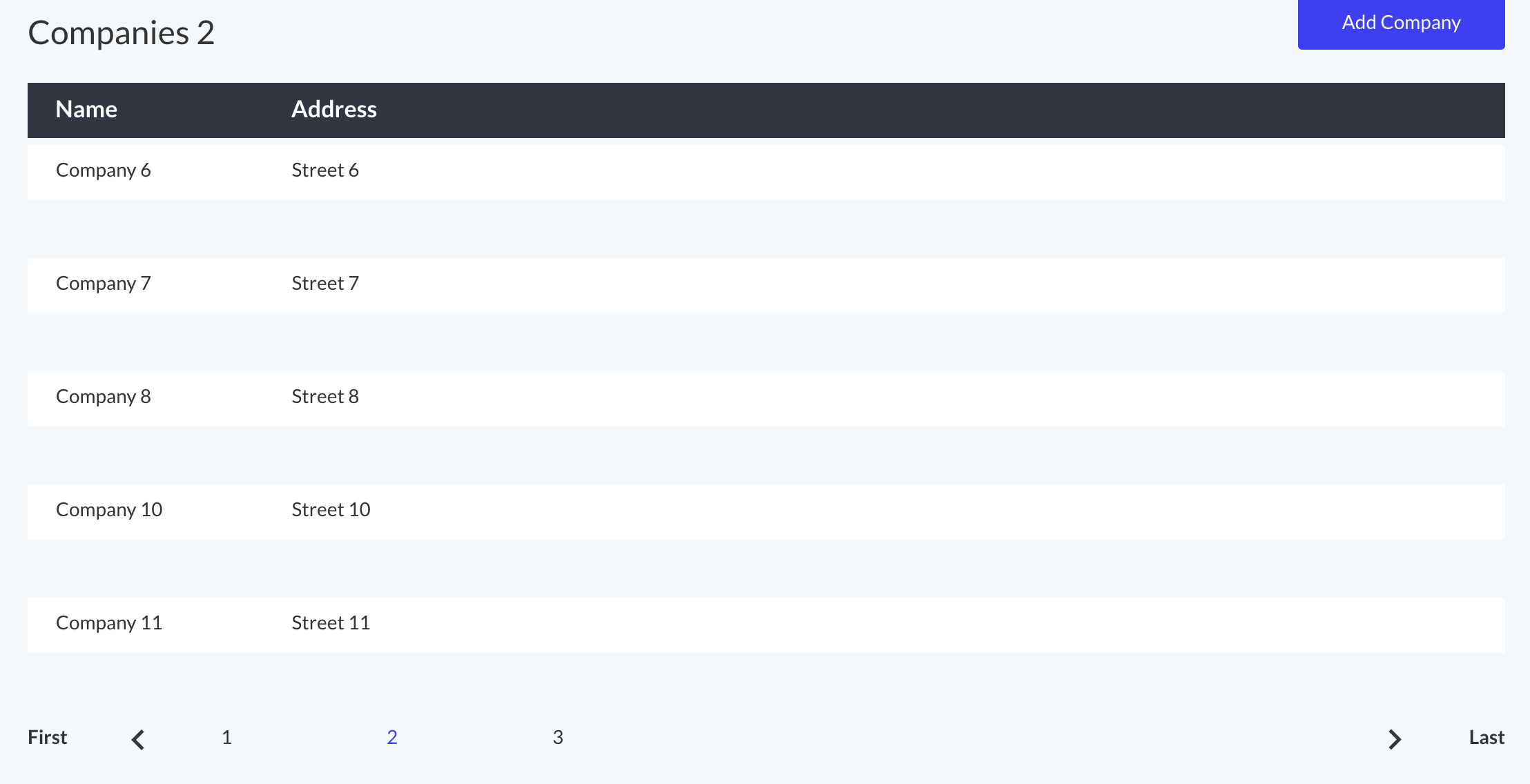

So far so good. But now I want to only show the left over items on the last page (whitout the previous records). Using a workflow I change the datasource of the RG to show items from a specific number. This works but then my pagination is broken because it is set back to only one page.
How should I change the source of the RG to only show from a specific item number on the last page, but at the same time preserving my pagination below the RG?
Thanks
Below some screenshot to clarify the problem I am facing (please ignore the spacing between the RG items):
Page 1
Page 2
Page 3 (Last page)
Problem: Page numbers are reset to 1.

@romanmg came up with a solution for me that worked. I can’t remember all of the details but something about dividing the number of records by the number of records per page. using this you can determine the last page, which I think you need for a custom state. That calculation also enables you to determine the start record # using the number of pages rounded down times the number of records per page plus 1.
So if you have 611 records and there are 30 per page, 611 / 30 = 20.367 So you round down to 20. Then 20 x 30 = 600 +1 = 601 which is the record number to start on for the “last page”
Thanks All. I solved it searching other posts on this forum. I made an error in configuring the list of numbers plugin. I used the RG list of companies, but it needed to be do a search for companies…
