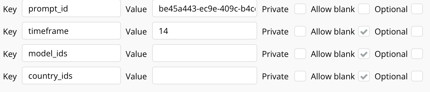

API settings are quite basic, here’s how I pass it in Bubble to Xano :

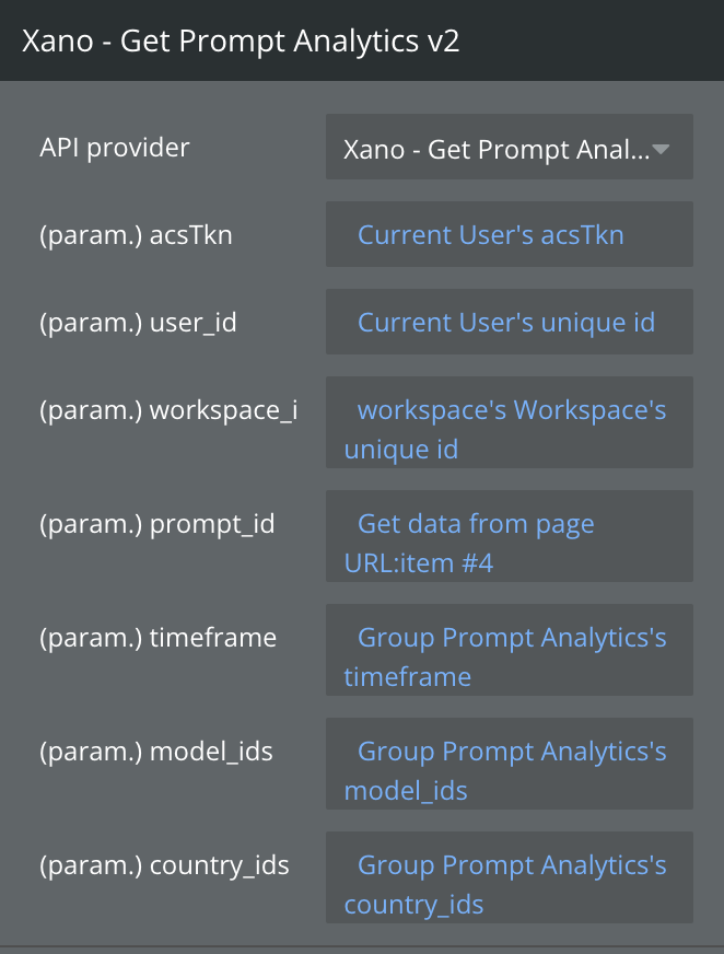

And here’s the call that I make to display the data in my main group:

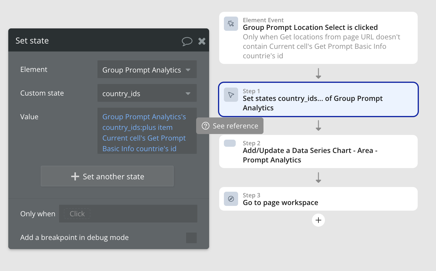

It is just the model_ids and country_ids I am having trouble with. Here’s how i change the group state when a user selects a country:
Bubble doesn’t add a trailing comma to list. What I believe is that you may have an empty value in your state list.

Insert Current cell's Country's id is not empty on the “Only when…” of the action “Set state ➜ Group Prompt Analytics ⇢ country_ids”
Bubble only spits out a trailing , when there’s an empty item hiding in the list.
