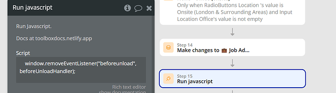

If anyone has any knowledge whatsoever how i could go around this, it would be immensely appreciated! I am dropping some screenshots below with the things i’ve implemented. Thank you in advance!

and then this code for the javascript triggered by another button:
window.removeEventListener("beforeunload", window.beforeUnloadHandler);
Unfortunately it doesn’t remove the event, but i can confirm that the warning is being shown. So the first code works, the remove one doesn’t. Attached screenshot to confirm it.
Am i missing something and doing it wrong?
