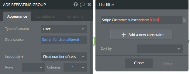

I get this far, but it’s not letting me enter anything useful in the “Stripe Customer subscription” field.

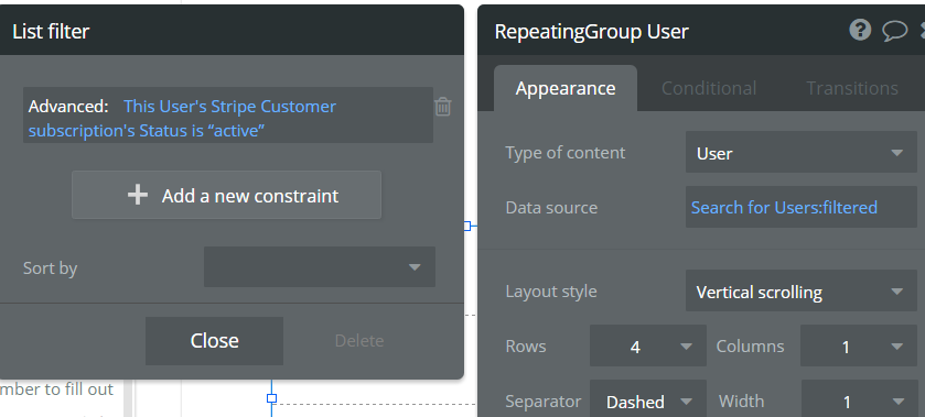

@sorensong oh you’re right. Looks like subscription contains a few different fields including status. Ok, do this instead:
That was it! Rockin AND rollin’ now! Thanks a ton @romanmg!!
