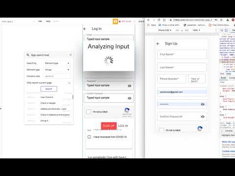

@J805 Thanks for the info. I just tried your tip but unfortunately, I still have the problem with my specific project. Do you have any other ideas? What would be an example of if I have something overlapping?
Here is a video of my problem.
Check out the page height. It looks like your page is longer than it needs to be.
It looks like there might be some overlapping as well which mean one group on top of the other instead of below each other on the page.
First, try the page height first. That will probably make things a lot better.

@J805 Thanks Jason. I Tried adjusting the page height but still no luck. When you say “one group on top of the other instead of below each other” could you clarify what that would look like? I have attached an image of how my groups are set in my elements tree.
If you could share the editor with me then I can have a better look. Send me a PM to get my email that you can add as a collaborator so I can take a quick look. :blush:
Ok, I got it. Let me send you a screen shot with an explanation.
Ok, here you go. Check out this screen shot. Right now you have overlapping elements, what you need is to stack them on top of each other instead. See image attached:

You can also show and hide each element with set states, I didn’t check to see if you were doing that or not yet. No need to “show this” and “hide this”.
Ooooooooo Thank you SO MUCH. I will try that right now.
No problem! :slight_smile:
That works! OMG THANK YOU SO MUCH! Seriously can’t say enough how much I appreciate it. I may need to hit you up on some of your No Code Training soon. Thanks again. Wow thank you.
