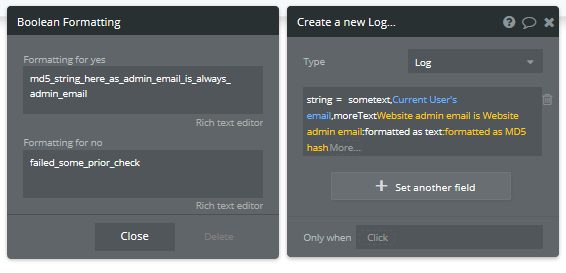

Experimenting with a fixed string plus current date/time:

How can you format a combination of information as an MD5 hash though?
When the combination has static text at the end it won’t allow me to ‘format as…’
Ran into this myself without finding a solution, but there must be a way to concatenate static strings with dynamic values and have the entire result put through a hash.
Hopefully ideas emerge!
Cant you just setup the string as a custom state a step before this one? That way you should be able to have this step be Index’s custom state:formatted as MD5.
In my case, this is needed in an api endpoint.
you could create a thing instead of a state.
Of course, transient things in the db…I use those elsewhere and didn’t here. Thanks @jarrad
I know its not the most ideal method, usually when these types of things pop up for me I try and find a couple of uses to justify it to myself, like create the temp record first up, dont delete it at the end - then is duplicate api calls come through you have a record of a thing with a modified or created date to ref for rate limiting and what not.
That’s the silly thing, I am already creating a thing that is part log, and part action item, I just need to add a field to store this hash. So simple, but I made it complicated. I let my need for efficiency get in the way of effectiveness!
I hear you, I think we all find ourselves in that bubble at some point. another thing you could do (this is good for security measures also) is,
in your case @JustinC you needed something dynamic at the end - that last statement even if was unstable as in unknown to be true or false you just fill both yes and no with your MD5 hash, but it also makes for a great flipflop for security measures.
