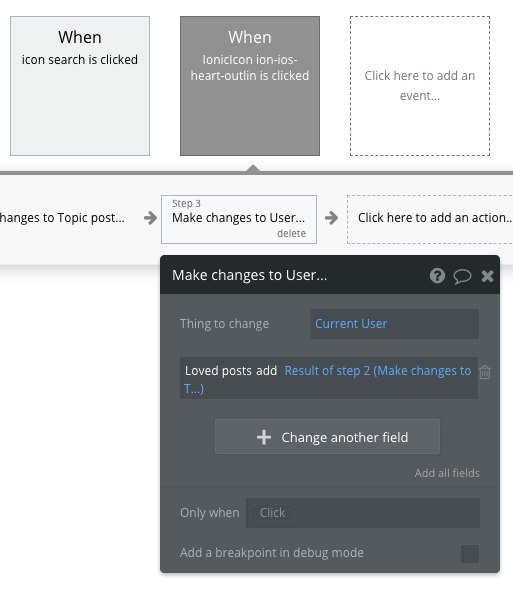

Here’s what my current workflow looks like if the user presses/likes the button:
It sounds like the workflow has to do the reverse of whatever step 2 & 3 are doing. If you share screenshots of those actions, I might be able to help you.
I would guess that step 2 is adding a like to that topic (either by count or add the user to a list of people who liked it) and step 3 is adding this topic to the list of liked topics for that user.
Thank you for replying Rico! What would be the steps to reverse that if the user clicks/ presses the button to unlike the topic?
Here are the photos of the steps
Two “On click” events … only when “this thing is not already in the list”…
…Add it
…only when “this thing is already on the list”…
…Remove it
