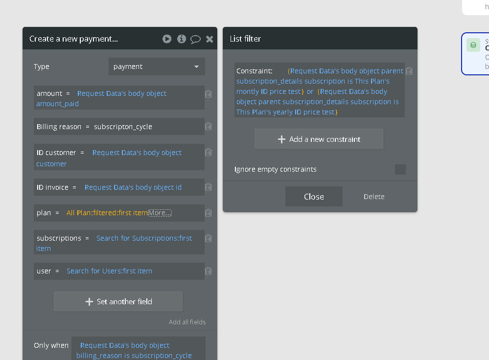

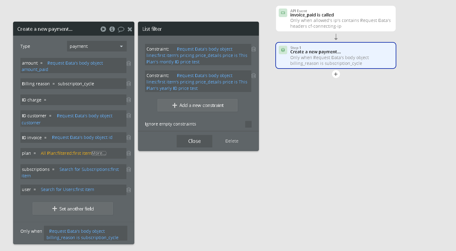

for and endpoint for invoice paid for instance i try to create a payment and will define the plan in the payment and depending on the plan also get an amount paided.. but the only logic there make sense for me is making 2 constraints in the search but i also think bubble cant figure that out like that..

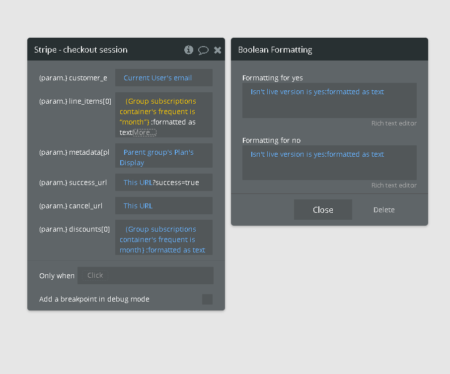

same thing when i try to create a checkout session.. i cant find the logic for the line_items[price] either
Your “Create a new payment” constraints won’t work because you are saying the request data has to have both the monthly Price ID and the Yearly Price ID, when it will only ever have one or the other.
Better to have an additional attribute i.e “Plan Type” of “Monthly” or “Annual” and do a “is Monthlys Plan ID: format as text” condition - if its monthly, it must be the monthly price ID you want. Otherwise it must be the annuals price ID.

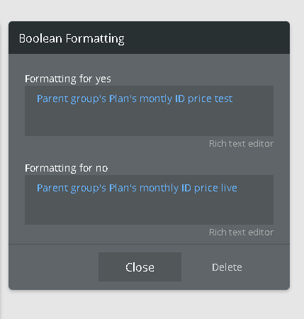

This actually looks like what you do in the second screenshot, with the “Yes” condition evaluating to either dev or live monthly price ID and the “no” condition evaluating to either dev or live annual price ID.

But what i do in second screenshot doesnt work either.. then it comes with a 400 error in stripe when i chose yesrly price id

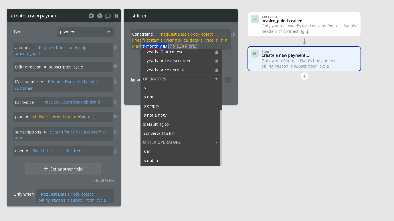

And in the first screenshot i dont get to use the format as text action
as you see i cant use the format as text as an operator in this expression..
i have tried to make a option set called frequency and option called month and year and modified each attributes to the different price id’s now.. but still cant find the logic for the expression as you see above
You need to go to the next “more” to find the formatted as text.
