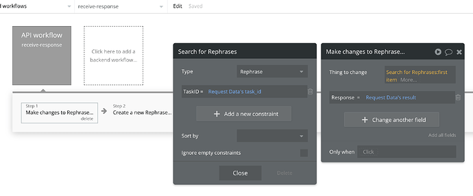

I have a database type with 3 fields: TaskID, Input, and Rephrase.
The TaskID and Input are added to the database record at one time, and then after a delay (a custom API processing), the Rephrase is returned through a backend API post request. If I add the API response to the database as a new record, it works fine, and I can see the Rephrase in my database. However, I want to update the existing record that contains the TaskID and Input. Attached is my configuration, what am I doing wrong? The current configuration does nothing.

Take a look at the screenshot.
The bottom record exists in the database prior to the backend workflow firing/the API response returning to bubble. What I would like to happen, is that when the API response is returned, it searches the database for the matching taskID (which is included in the API response), and if it finds a match, updates that record to fill in the Response field (also included in the API response.
You’ll see in the top record in the screenshot, that when I try to “Create a new thing” instead of “Make changes to a thing” it correctly adds the API response to the database. This tells me the API response is working correctly, but for whatever reason, bubble isn’t able to update the preexisting record based on the taskID. My goal is to have all three fields in the same record.

Prior to the API response, there is a record in the database that includes the same taskID and the Input. I want to update the pre-existing record that has the matching taskID to fill in the Response data field returned from the API. The attached screenshot shows the preexisting record on the bottom and the result of creating a new record from the API response on the top. I want only one record.

Yes, the Create new Rephrase is just to investigate the issue.
The taskID is necessary for the API. The initial workflow is: User types in input–>POST request to API with input–>API immediately responds back with taskID–>Input and taskID stored in database–> API processes input (There is significant delay in processing the input, which is why I use a taskID through celery in my API)–> when API is finished processing, send POST request using backend workflow to bubble with the taskID and output.

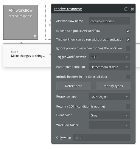

Okay, looks like you have set up a webhook or a public API and not just an API workflow that is invoked internally within Bubble application. (You’re sure it is needed to be done that way?)

Your receive-response API workflow is set to run without authentication, but isn’t set to ignore privacy rules. Are there any privacy rules set for your Rephrase data type? If not ‘everyone’ can see all Rephrases, those settings could explain why your workflow can’t search for and find the Rephrase it’s meant to update, but it can create a new one.
It’s a shot in the dark, but worth checking.

That’s exactly what was wrong. The privacy rules were preventing the backend workflow from reading the taskID in the database. Checking the “Ignore privacy rules when running this workflow” worked. This is my first bubble app, so I’ll have to read up on the privacy rules to figure out the best way of implementing this.
