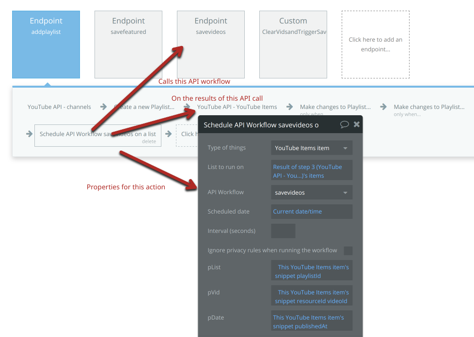

You can Schedule an API workflow on a list of API results directly. Below is an example:
Thank you for your reply. I feel like I’m missing something here. Is it possible to see that entire workflow and associated api workflow?
Sure, does this help?
So the selected action is one of type Schedule API Workflow on a list. It schedules an API workflow called savevideos on the (list of) results from an external API Get call to YouTube.

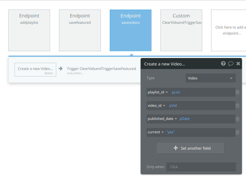

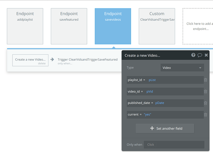

Ok, i think i’m understanding better. Can I see the endpoint savevideos workflow? That is what does the database saving correct?
Yes, it is. It looks like this:
Ok, so in your first post the list you run the scheduled workflow on is the result of an api call to youtube, you seem to have an option I don’t have. When I set the list to run on I cannot select items, I have the option for first item, last item but not all items in the list.
Try selecting a ‘Type of things’ that corresponds to your API call. Note that I don’t mean database thing. So in my first post, the ‘Type of things’ “YouTube Items Item” is not a table in my database. I struggled with this before as well, until I realised I could select an API in that type dropdown.

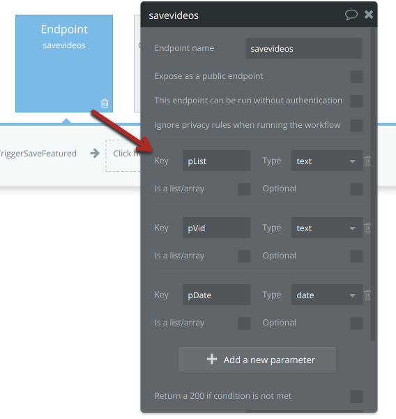

ok, so i can get the database to create entries but as far as saving data from the api call, I don’t seem to be able to create the field variables like you did on your first post. Where you schedule api workflow save videos and you have plist, pvid, etc.
Oh you have to define the endpoint you’re calling such that it takes parameters. Apologies, I should have included this before:
You should then be able to set these parameters from the results of your Particle API call and later use them in saving values to the database.

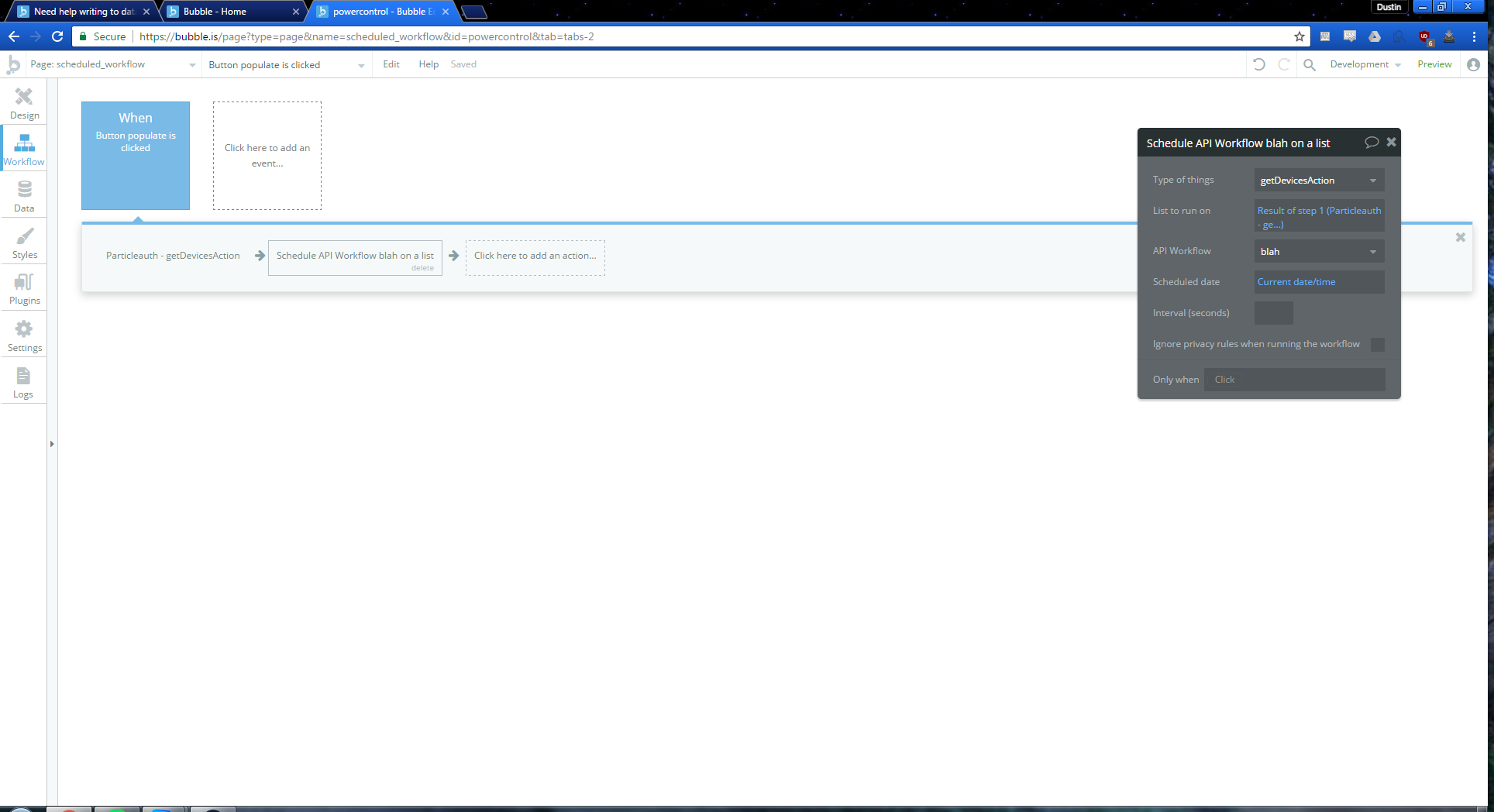

in this screenshot there is a workflow called "ParticleAuth - getDeviceAction and @louisadekoya has “Youtube API - Channels”. What is this step? Is it a custom event to call up the API? I have my API set up fine, I just cannot seem to figure out how this is a workflow on an endpoint. Thanks for any help!
figured it out sorry! my API was setup as DATA not ACTION
