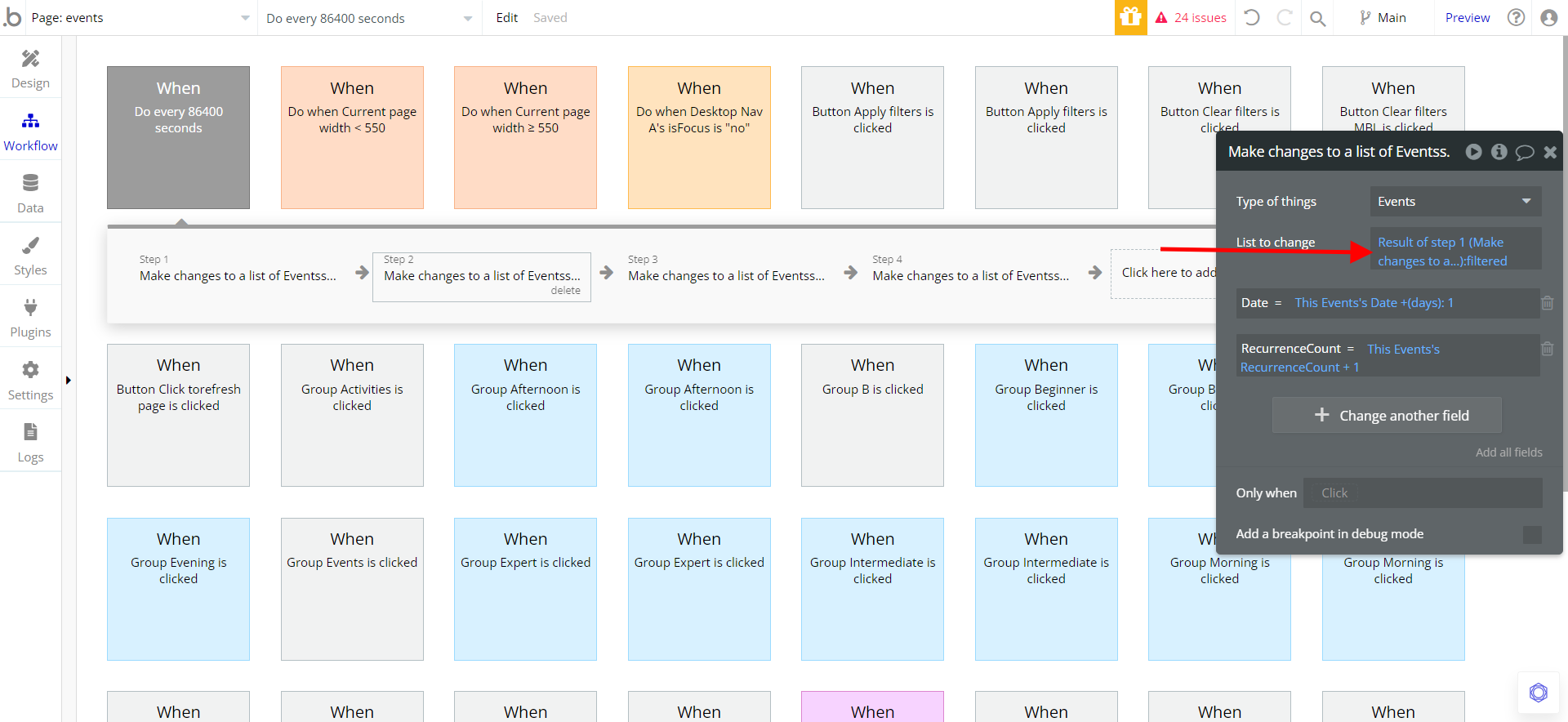

No worries, I’ve managed to get it working. I used a Do Every X Seconds workflow. I used advanced filters to compare the fields I needed.
Are you doing a search every second? I hope not or you’re going to blow your WU.
HI @ihsanzainal84 it’s every 24hrs. Is there another way I can do it. I just need a way to update the dates of recurring events if the previous date they had has passed.
I do a search with constraints on the first step, then do this on the second step for events that their recurring frequency is daily.
Are you really expecting your users to sit on your Events Page, and keep the browser tab active, for 24 hours at a time?

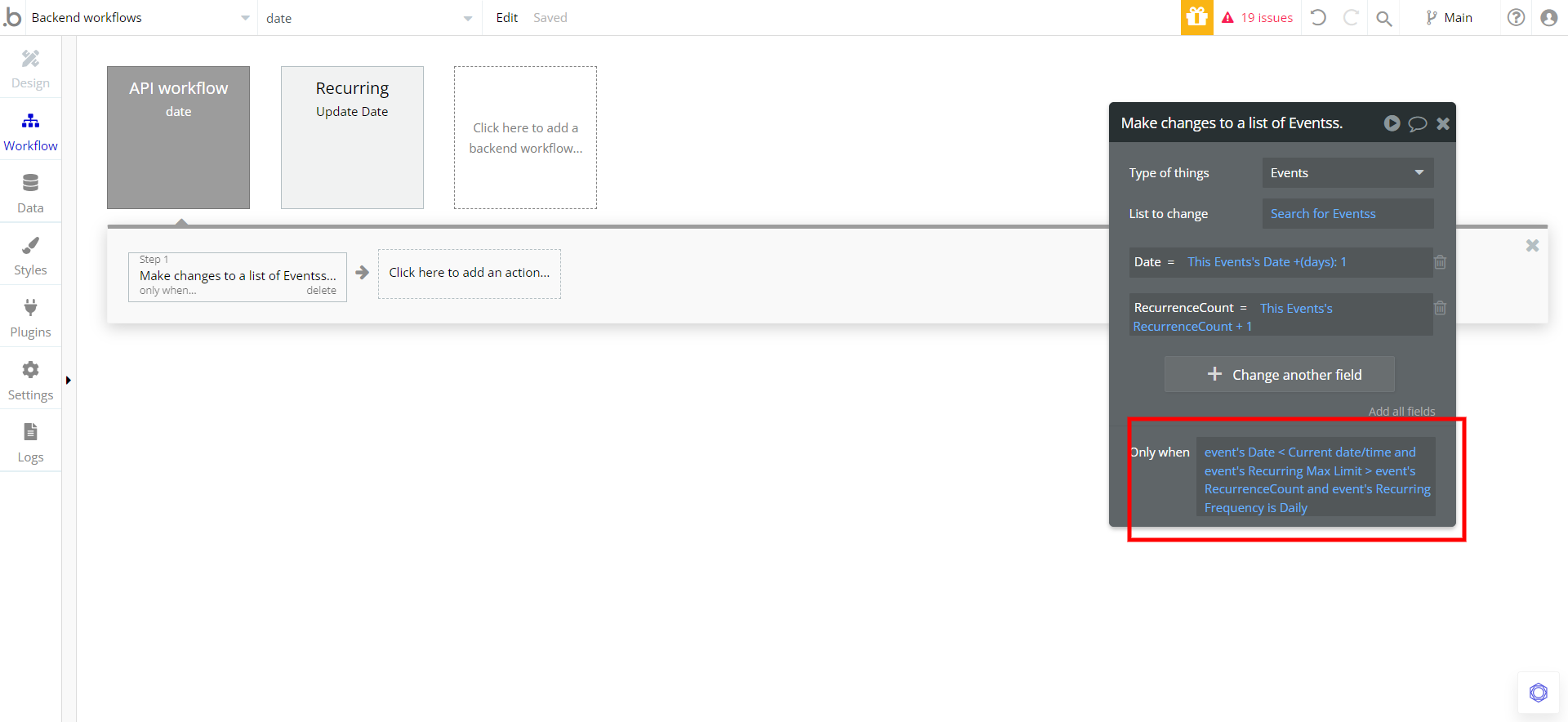

HI @adamhholmes I tried to use a backend workflow, but I couldn’t see “This Event”> I need it to check this condition “Recurrence Count < This Event’s Recurrence Max Limit”. The condition checks if the event has recurred the max number of times it is supposed to. Is there something that I am missing?
@georgecollier I tried to create a backend workflow, then when I tried to bring it to the frontend to trigger it, I noticed it only accepted a type of thing and not a list (mine is a list of events). So recurring event didn’t work either. Did you mean something else? Please see the attached screenshot.

That’s because you need to add Event as a parameter to the backend workflow.

I have managed to get the API workflow to work now. What does the number in the intervals mean? Is it the time before it runs the workflow on the next record? (Eg Run for first item, wait 3 seconds, run for second item, wait three seconds, run for third item…) or is it the frequency it runs the workflow on the whole datathing?
If it’s the latter and the frequency is 24 hours. Why is it better to have it as a backend workflow vs having it as a normal workflow?
Because normal workflows only run when the workflow is triggered on a page. No normal workflows run if the user isn’t on your site.
This, just leave it blank
Oh, even “Do Every X Seconds”?
Okay.
I ran into another problem. Added these conditions in the backend workflow but records that don’t meet these conditions still get updated. I don’t know why that is happening.
