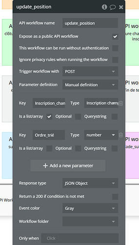

I finally found a solution!! Here is my method
I created an API endpoint (WF backend) with my data type (championship registration) that has my total points (in list
Then a 2nd key of the number type
The first step is to change the make change list on the item#Ordre_trié created before
For step 2: shedule api workflow with a condition
Then on my page in a WF, button or whatever you want to call this WF API and indicate on which list you want to update the position. added a sort (in my case the total points)
In sorted order started at 1
And there you have it, this way you can now under API call, anywhere, anytime in your application update the position and save that order from the 1st to the given xxx of this list.
