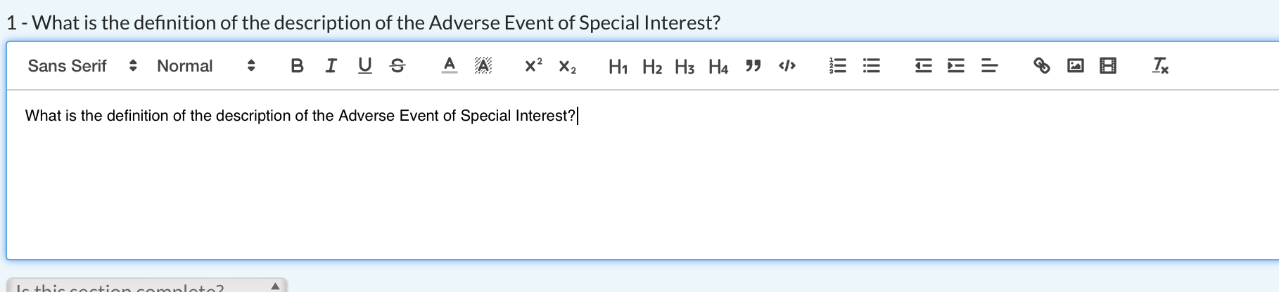

I also realised whilst investigating this issue that Bubble may not display trailing spaces in the Rich Text Editor in the front end reliably. It would show trailing line breaks (or possibly spaces) in the back-end data tab. What ever was in the backend data tab, was in fact the true representation of how the data was structured - and because there were line breaks, it would result in errors - despite first glance from the data in the front end indicating no issue. I sent the issue back to support if they want to use my app to look into it further.
It does, it’s just not very easy to see because whitespace is, well white space, which is shown on a white background. There’s no bug here :slight_smile:
Okay, but the second anyone puts in quotes or maybe backslashes in the input it’ll break.

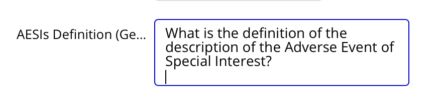

I tried to use my arrow keys to move the cursor as far as it would go to the right and down as to move onto a new line (if there was a line break there). But it didn’t do either. This is as far the cursor will go right
And this is the data tab - with the cursor sitting at the line break for the same field (I’d expect to see it to the right of the question mark as per the form):

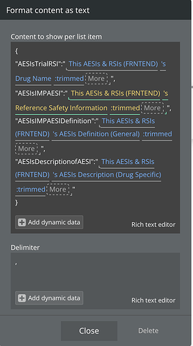

You are right about the JSON-safe expression, and I would like to use it, but my integration is expecting the format to be like this (which is how I written it out in Bubble
With the JSON-safe turned on,
I’m assuming I can remove the quotation marks around the Bubble expression as the output seems to double them up
Yes, just remove the quotation marks and you’re good to go. Format as JSON-safe always puts quotation marks.
