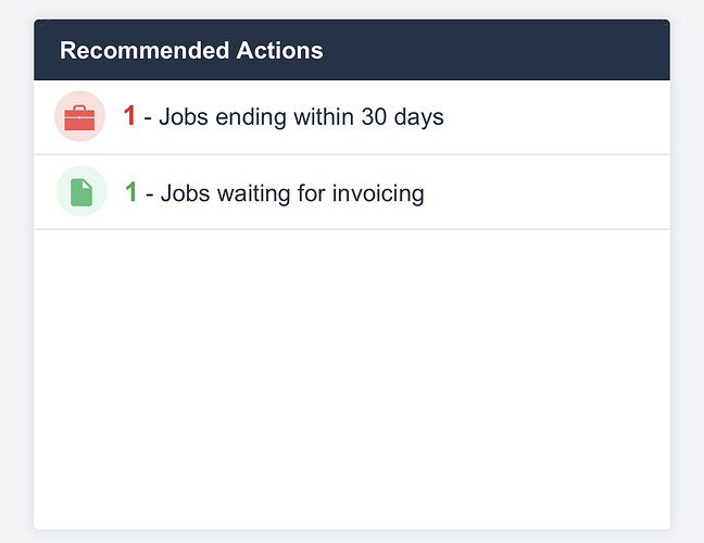

Wondering if anyone else noticed that when using font awesome icons via ‘fa’ tags in a text box on IOS, they aren’t showing? Web works fine.
Here’s an example:
Here’s an example:

Just checked on my apps and app is working fine on both chrome and iOS . If you want to share a link to your app on the back channel happy to check

Hey @bramat.dev,
Thanks! So I did some testing. And I was under the impression that Bubble is already loading the Font Awesome Library (I could be wrong). Anyway, by placing an icon on the page, it does in fact now show on IOS. ALSO, when I delete the icon, the original ‘fa’ tag style now works on IOS. Seems like Bubble’s on page load is not capturing which one to load on page load.
Thank you for the tip! It’ll be my quick fix until I figure this out.
