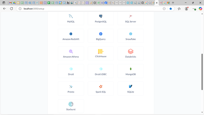

API connector doesn’t seem to be an option with Metabase. Here’s what they have from what I can see:

Sorry, I don’t understand…Bubble API connector is setup, what I want to do now is read Bubble data in Metabase ( so I can produce dashboards etc) but I can’t see how to do that.
Ha Sorry. I don’t know if this is possible in this case. Bubble allow DB access using API.
Youcould maybe consider using your own DB solution (For example, Bubble have an SQL connector… so you could use MySQL in Bubble and fetch data to this DB from Metabase)

I’m using Metabase here, but you need to send your events to a database that’s connected to Metabase. Metabase isn’t a database—it’s a data visualization and dashboarding tool that requires a database connection to work.
→ n8n is free if you self-host it, just like Metabase.
→ BigQuery is free for up to 10GB of data processed per month, which can represent millions of rows depending on row size. After that, the cost is still very affordable—just a few dollars per month for tens of millions of rows.
If you’re on Bubble’s dedicated plan, it might also work by connecting directly to Bubble’s database via SQL.
I’m on the starter plan. I managed to connect Power BI using Bubble’s API and was hoping I could do something similar with Metabase.
Use supabase as databe, it has a very decent free tier. Send the data through API and then connect it to any BI tool. I’m using this approach right now.
