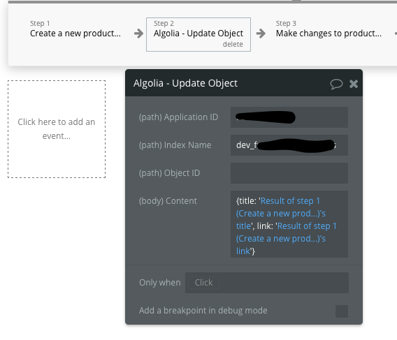

I’m using the ‘update object’ action. I know my Algolia application ID, and the index name. I can see that the ObjectID probably refers to the Algolia record, but I’m not sure how to access that from Bubble.
When I looked at the documentation, it was referencing lots of “tasks” and I don’t know what those were referring to.
I’m creating a directory and I want to make each record editable by the user.

Any tips on sending the Object ID from Bubble back to Algolia? Since that is an Algolia field, I’m guessing that it should be saved to the Bubble record at some point, so it can be sent back to Algolia…
A little more context, here’s what I have right now:
- I make a new record
- I do use the “Algolia Update/Delete” to add the record to Algolia. I leave the ObjectID blank to create a new record
- I use the “Make changes to product” to update the AlgoliaObjectID in the Bubble database, but it is having some trouble. I’m trying to use “AlgoliaObjectID = Result of step 2’s objectID” but it is throwing an error.
Oh, hmm, it seems as if I can just send the Bubble ‘unique id’ to Algolia when the record is being created to use as the ‘ObjectID’, and that will make them in sync.
