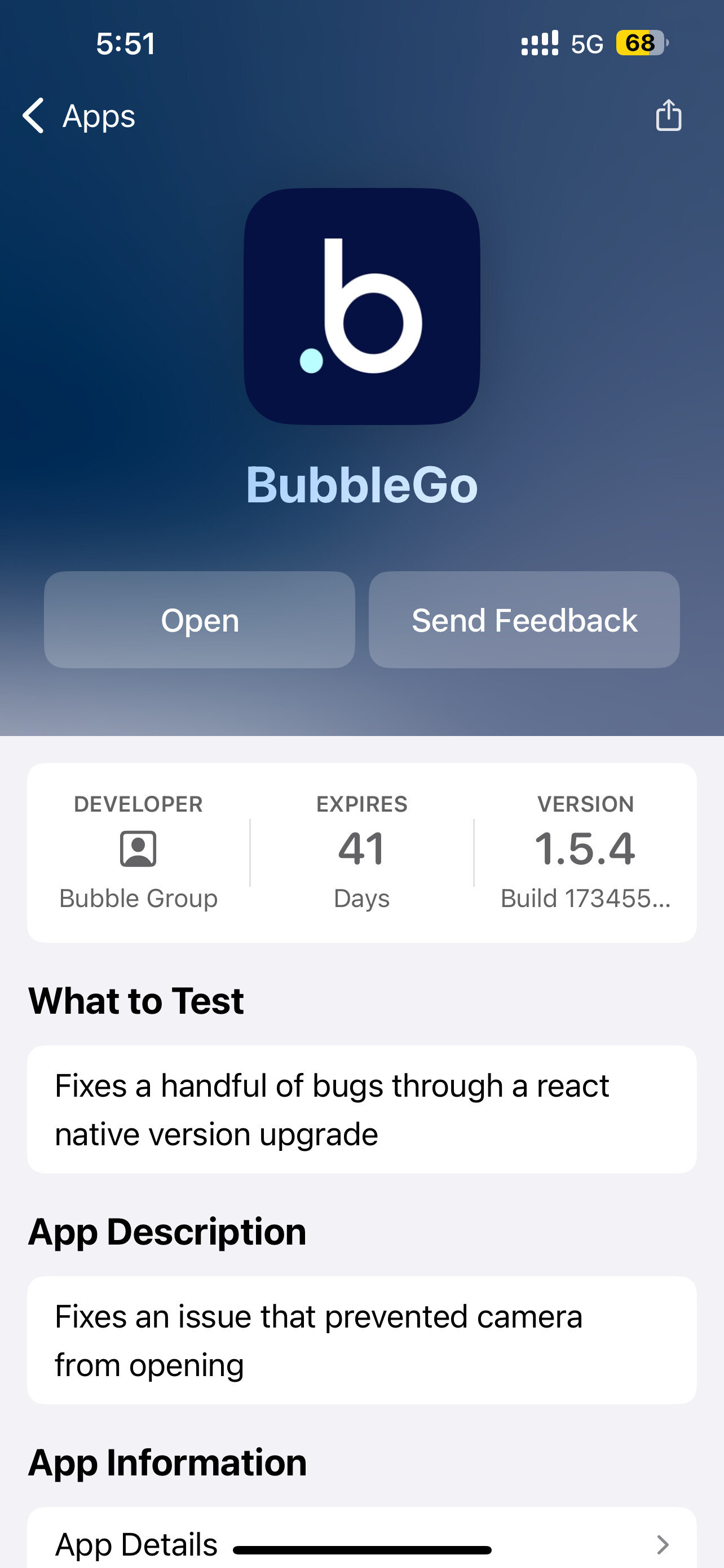

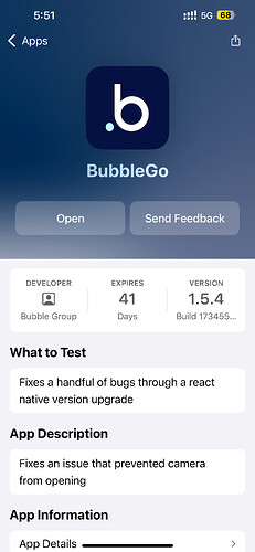

Hi
I’m using version 1.5.4 and seem there is no update option on test flight.
Oh shoot, looks like the updated version is still in review. Will circle back once its out, but its possible that may be it
It’s fixed now after updating to 1.6 :grinning:
Thank you so much , this thing drive me crazy for a week :rofl:
