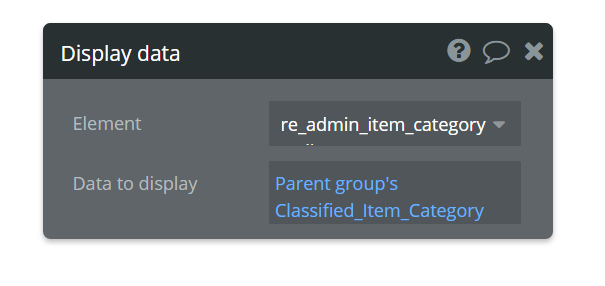

When the row is clicked you put it in the the “Data To display” parameter of a “Display Data” action.
Then you would Show Element action and select the popup.

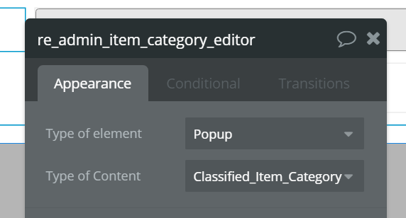

The in the popup, you set the “Type of Content” to the same.
