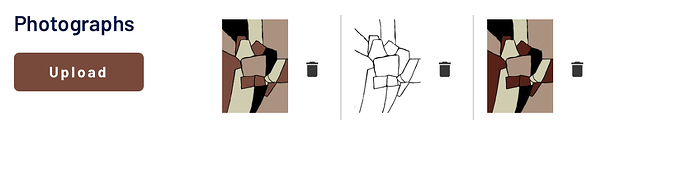

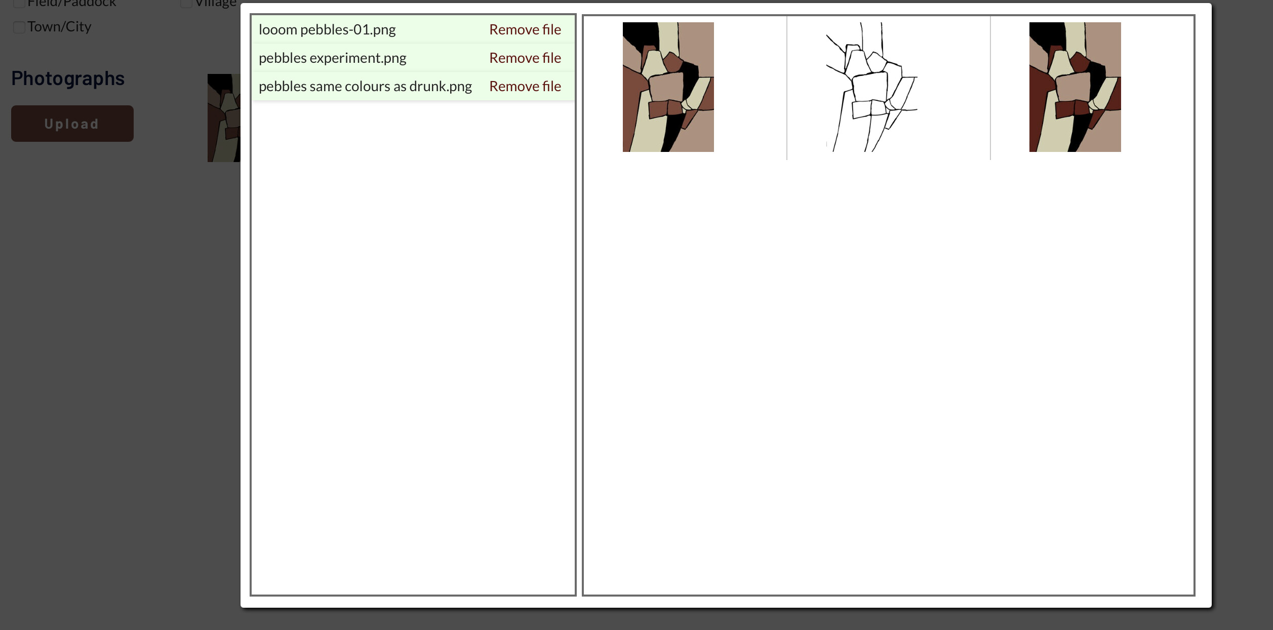

On my website I will have an ability for users to create listings with multiple photographs. I am using multi-file uploader for this purpose. My set up is an “upload” button, then a pop window where on the left there is the multiple uploader and on the right a repeating group showing thumbnails of the uploaded photos.
When the user exits the pop up, I have another repeating group showing thumbnails of the photos and a delete icon to the right of each image. I can’t quite figure out how to make sure that when the user presses the icon, the uploaded file is deleted and disappears from both the uploader and the repeating group.
I want the user to be able to remove photos they just uploaded, by pressing my own delete icon, instead of from within the multi-file uploader, by pressing the remove button.

Great question! So the goal here is to “sync” these two lists whenever a change is made to either is that right? One way accomplish this might be using the “Initial Content” property of your multifile uploader.
First you’ll want to store the list of files as they are edited in the multifile uploader in a custom state or other temporary storage, this value will need to be outside the group that contains the uploader. The workflow should look something like “when this uploader is changed set state list of files to uploader’s files”. This value will be the data source for your repeating group that contains the trash can icon. This state will also be set as the “Initial content” of your uploader.
Then, you can add some actions to your delete workflow attached to the trash can icon. In addition to removing the file from the list, this time from the custom state we’ve set up, you’ll also want to trigger “Reset Group/Popup” and reset the group that contains your multi-file uploader. This should force the uploader’s list to reflect the “Initial Content” which is now our updated list!

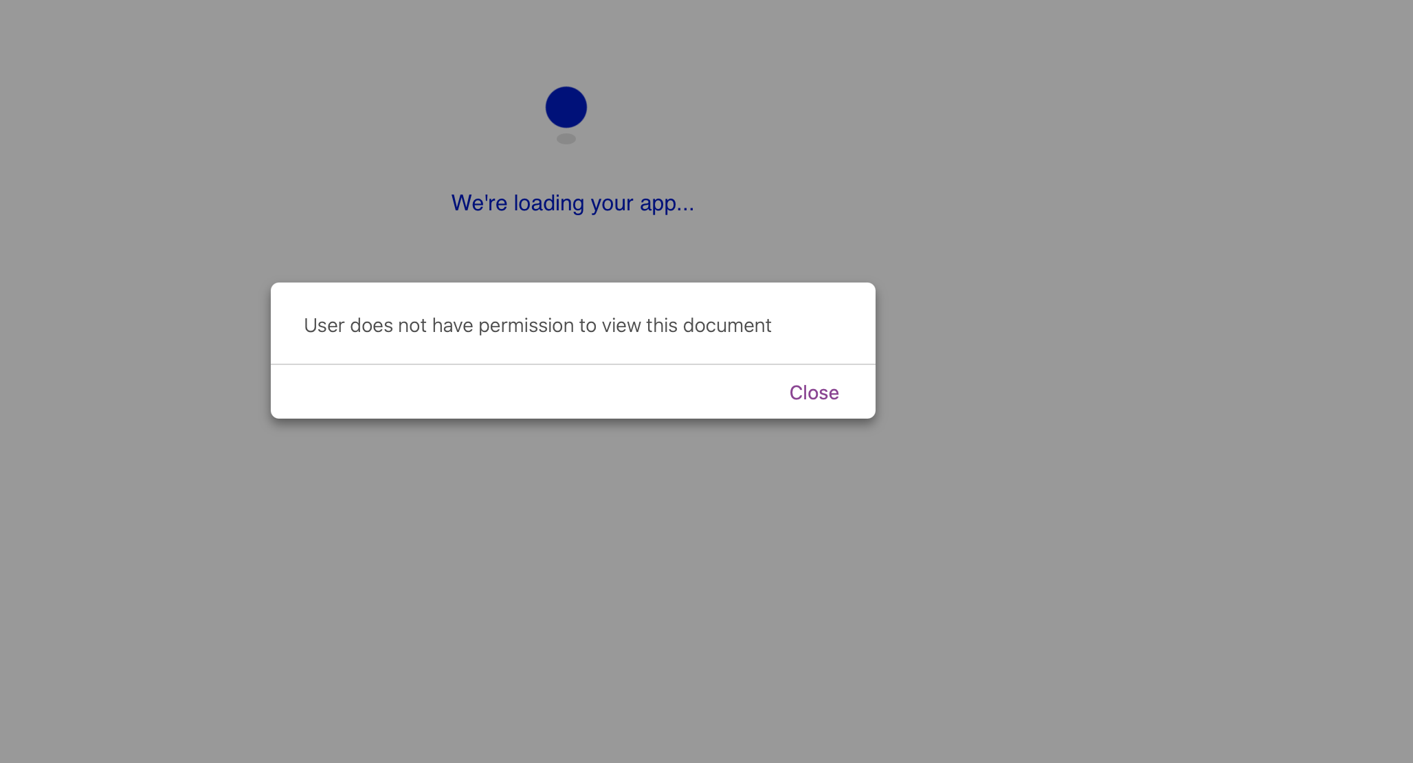

@boston85719 thanks a lot! I started following through, but got stuck at the Schedule API step… I don’t seem to be able to create backend workflows similar to what you have in your tutorial. Am I missing something?
@boston85719 when I click on tutorial materials, to see the backend workflows, I get a dialogue screen with a message saying I have no access to the document
Have you been able to access it? I tried to reproduce the issue you described but I am able to access it. Did you successfully access the materials?
hello @boston85719, sadly still doesn’t work, please see the the photos attached. I did manage to set up backend API manually, however. I am now playing with the set up and run into a problem - multiple file uploader’s value evaluates to a list of files, not images. When we merge a list of images from the custom state with a list of files from multi file uploader, nothing is visible in the repeating group. I managed to solve this issue, I think, by setting custom states to list of files, instead of images. Wanted to let you know to see if you are aware of this issue and if my solution is what you would have done, thanks xx
