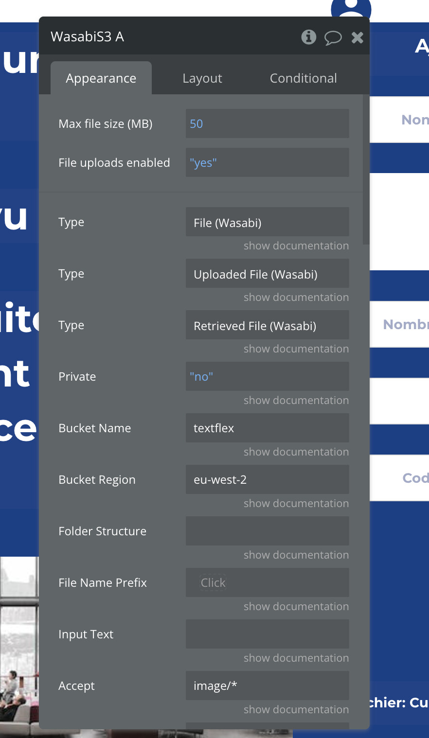

I’ve uploaded some lists of images to Wasabi, but in every folder I revealed strange file - “test.pdf”, which we saw as example inside of property panel (see screenshots
How I can check if it any bug, because we haven’t got this file in our database (see screenshot).

Hi @nerpa.custdev, thanks for your questions.
This file is set only as a default example, so the user can see where to insert a filename and file URL.
This URL link relates to one of our Bubble applications, so yes, it will not be present within your database.
On workflow setup, please replace the default values with your own.
