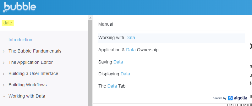

If I search the manual for date, the result has absolutely nothing to do with dates:
