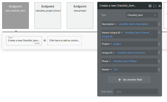

Alternatively screenshot of your workflow?
Here are some screenshots of the workflows.

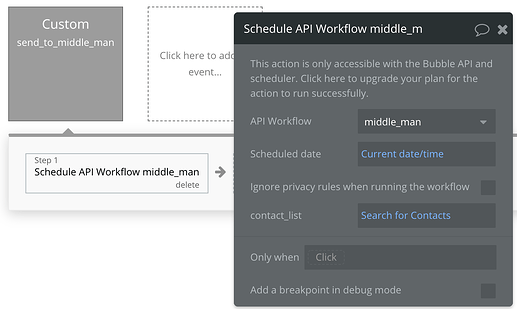

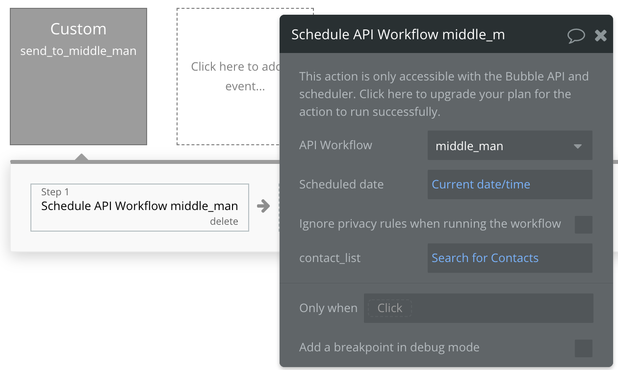

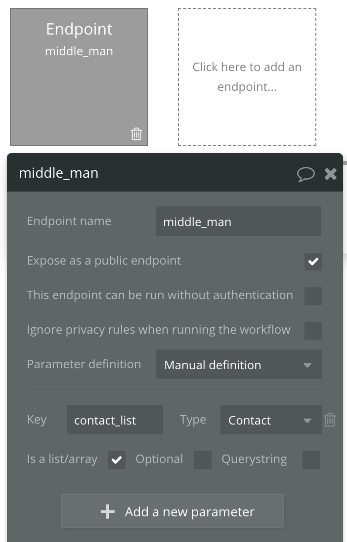

You might try having a “middle-man” endpoint to see if you achieve better results.
Create an endpoint which has the sole task of receiving a list and the let IT be the workflow that schedules the individual add_checklist_item calls. From the client side workflow, schedule an api (not schedule on a list) and pass the list as a single parameter to your middle man.

Would you mind providing a screenshot of how you pass the list as a single parameter to the middleman?

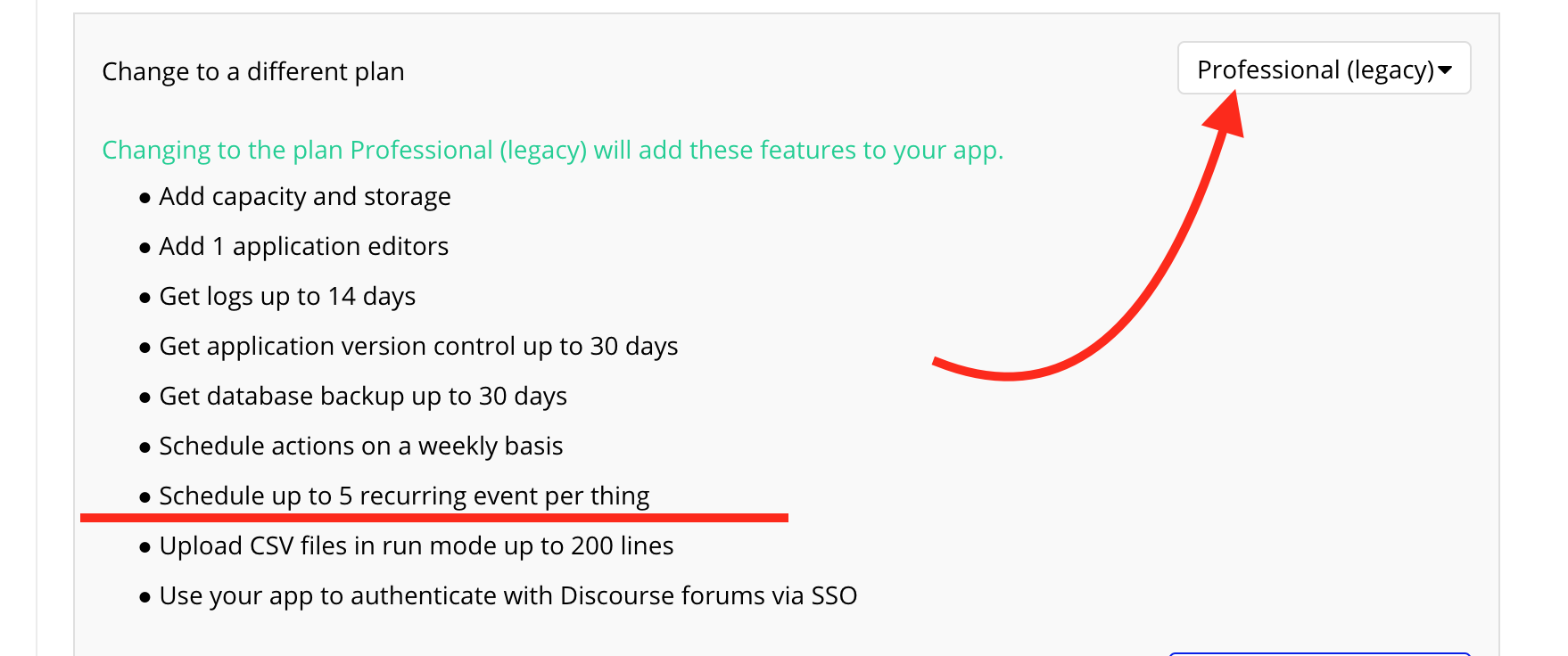

Schedule up to 5 recurring event per thing
This is new for me. It mean for personal plan is 1 recurring event per thing.
What exactly does that sentence entail? That scheduling on a list on a Professional plan can apply to a maximum list count of 5?
As far as I know, this only gives the number of “Recurrning Events” that can be created. I did not see a restriction for “Schedule API Workflow on a list”. I have fourteen in my app with a “Professional Legacy” plan.
Yeah, I’ve been scheduling a shitload of lists over the last year, never noticing that :slight_smile:
But I’m still not 100% clear on this. Recurring event, I take it, are API workflows that have a repeated schedule, such as monthly or daily. It’s the per Thing that makes this confusing. I can schedule a limited amount of recurring Events per Thing?
How is that calculated? A repeated workflow can affect one, or hundreds, of Things?
Also, their pricing list says that Professional supports Daily schedules, but this list says weekly. Was this increased after the price changes? So legacy only as weekly?
I’m not sure, let me tell you, let’s hope someone corrects it if there’s a mistake.
You can create countless “Recurring Events” on the API workflow page, and only one data type is defined for each, and you can use up to 5 “Recurring Events” for each data type.
As with the New API Endpoint, you don’t have a chance to add many parameters. Just a “thing.” For example, User. And 5 repetitive events related to this thing.
Yes, unfortunately. The old plan was weekly, the new plan offers it daily.
