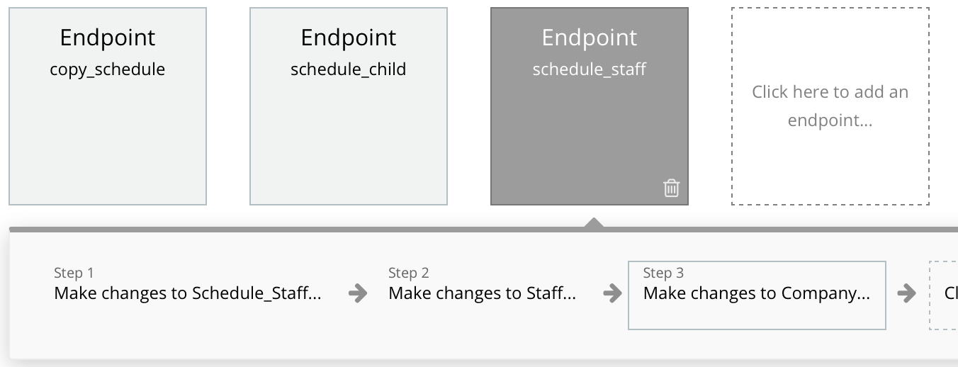

Here are some screenshots of the API. Not sure if it will help, but there it is.
This Endpoint will have a max of 5 items sent to it
This will normally have around 10-30 items sent to it
This will normally have around 1-10 items sent to it.
