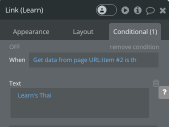

No. While true, there is more to the expression than simply referencing app text, it is not like you explained.
Screen Shot 2023-09-29 at 8.30.52 PM
Screen Shot 2023-09-29 at 8.30.47 PM
As mentioned, I don’t use the ‘users language’ and I instead use the URL path item #2 (akin to a sub-folder for language - but within Bubble constraints). I don’t need to load all option sets (they are pre-loaded anyway as that is part of their built in function as being ‘universal’ and much faster to display than data types because they are already loaded and do not need to be retrieved)…also, I can just simply select the actual option I want to display…no filtering necessary.
No. Don’t use users language. Uses URL path item #2.
It avoids the WU costs of loading a page and all of it’s data since the page is not having to be refreshed to display the newly selected language.
No. Experience is 1000 times faster when not using App Text for one main reason being there is no page refresh and a new page load taking place to show the newly selected language just to get the app text to change. Watch the video, it takes 1/2 a second to get the entire page language changed when not using the App Text and using the option set.

Also, I generally like to avoid putting too many conditionals like you have shown e.g. If language is th, then show Learn's Thai . I would prefer it to be more like All options translations: filtered 'where original text is <one variable> and language is <another variable>': first item's translated text

Yes, if I were building an app with more than the two languages, I may have taken the time to setup the option set for translations to use a variable from the option set that represents the language. My tip was not about detailing how to setup multiple languages in the app, but focused on why I won’t use App Text and why.
