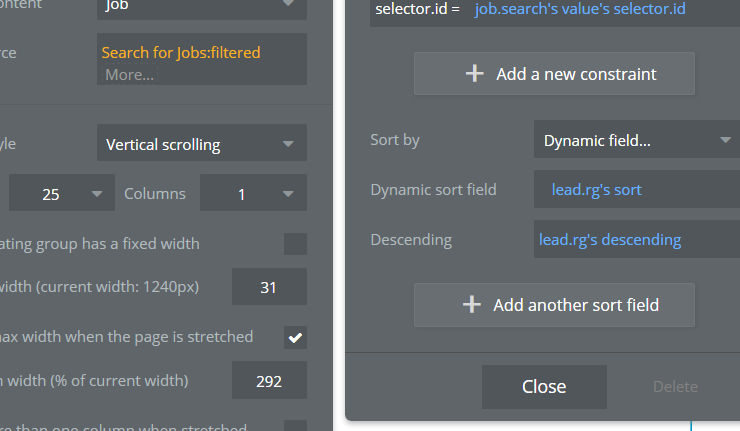

I’m trying to sort a RG dynamically which works actually very well, as long as the things (fields) you sort on are on the same level as the source of the RG. I have headers for each RG column that set the RG’s custom state of ‘sort’ to the field name’s value I’d like to sort on. Like so:
RG source = Search for ‘Jobs’
Things (fields): name, Created Date.
Click on header text ‘JOB’ or header ‘CREATED DATE’:
Custom sort RG: ‘name’, ‘Created Date’
This works great until a second level Thing comes into play.
Sorting on Job’s name is no problem, but sorting on Job’s Account’s name seems impossible using this method as Bubble does not seem to figure out which field to select for the sort. I’ve gone through many of the related topics on this forum, but couldnt find this specific issue.
I can add new conditions that if ‘this RG’s custom sort = value x’= data source= something to make sure to filter on a Thing’s thing but: 1. this is not very straightforward and 2. most often just doesn’t seem to work.
So how are you sorting RG’s on multiple fields? And why can’t I just select the second level thing to sort on and by default it’s primary field will be used?

It is hard because it is inefficient to do it from the “outside in” (so Job > Account) … so get a million rows back from the database, including linking to another table, then sort that million rows (in “memory”) on the returned data and then pick the top 20 and chuck away 99980 rows. You would face the same issue with an SQL query that accessed the data this way, it would end up scanning the whole table first. You would write your query in a different way to get round this.
Far more efficient to get the first 20 from the “inside out” (so Account > Job) and then list the Job data from that 20.
(assuming that you are only displaying the first 20 in your repeating group)
It is a little confusing, however. You can only sort on the Search for fields on the search’s data type. And the reference says that if the dynamic field is not found then it won’t sort. So it looks like it will work to put “Account Name” in there, as it won’t give an error, but it just won’t sort.
The way to do it, as @romanmg says is to have a list of Jobs on the Account, and then go from Account > Job and sort on the Account.
If I understand correctly, you can in fact sort on a secondary thing when you do not state the data source as:
do a Search for Job
but instead do
do a Search for Account’s Job.
This allows you to sort dynamically on Account and also lets you add a :sorted or :filtered constraint on the Job part of the string allowing you to sort on that.
