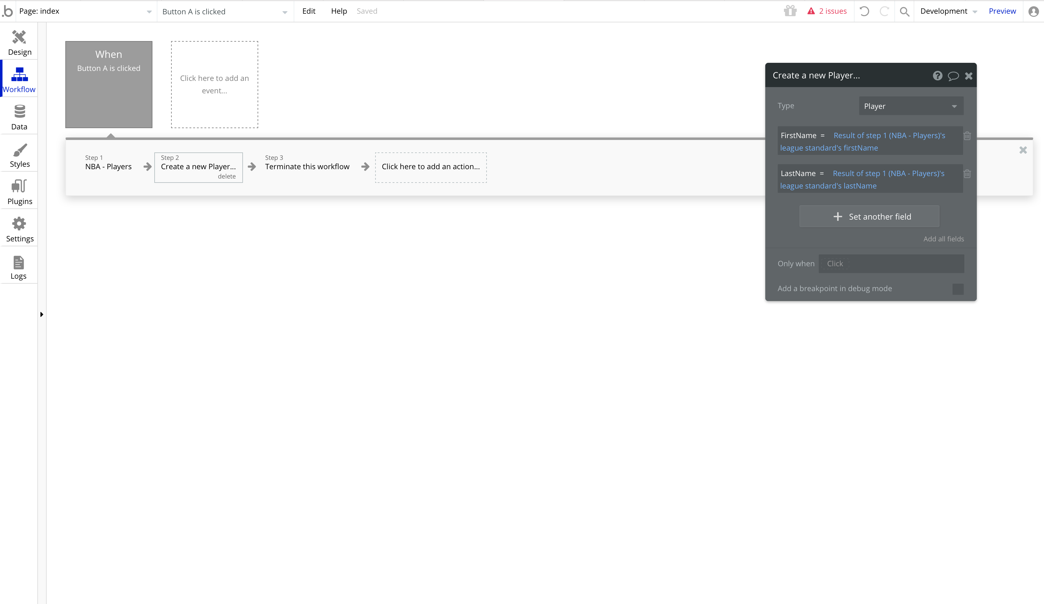

Another stuff that I’ve tried, adding the data in the database using a button.
I’ve set the following workflow on a button
I actually put data in the database but don’t create one entry per player…I just get one entry with all the data, correctly added in each mapped field but all gathered in the same field (got all players name in the same name field, etc.
I assume it’s either the API structure or my way to handle it that is not correct but can’t figure it out.
In addition, backend WF looks great but require a paid plan. Would rather use a manual way to update data, once a day or even trigger that data to be updated using Zapier or Integromat (if possible).
If you do that, you will take a large amount of app capacity and it will slow down your app a lot if you refresh this often. The way I tell you is a fast and easy way to do that. You don’t need to reproduce the DB structure of the json into your own DB. You just store the JSON payload and Bubble will be able to use it like it was a thing with is own field.
If you really want to go that wya you will need to use Schedule API WF on a list a provide all fields needed in your Backend WF settings. Or store it in DB first using the way I tell you and Loop each item one by one using the same WF until all item have been processed. It will take less capacity.
If you follow my way, you only create one item in DB. And set your field to “Players league " or “PLayer League Standard”. And in this field you will do a Get Data from API’s player league (or player league standard”. Don’t forget that if you use player league standard, you need to set it to “is a list”
