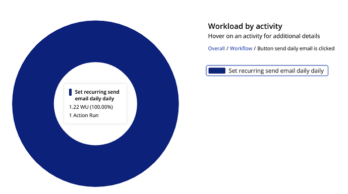

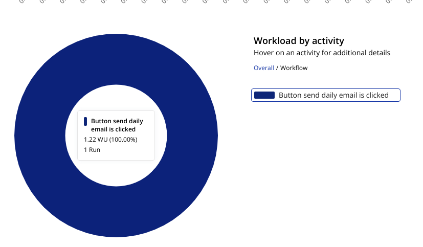

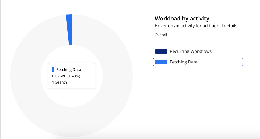

  1. Button click to set recurring action - Cost overall is 1.22 WUs for one run - this seems to be 0.62 more than it should be since, a button click trigger is not supposed to be charged, and there is only one actions, which should be only 0.6 WUs, and there is no indication in the charts that data retrieval (ie: individual data request took place, which, if it did should only cost 0.2 WUs) - so, where is 1.22 WUs coming from?
  1. Running the recurring Action overall shows 0.2 WUs for fetching data (the individual data request, which is correct) and the 1 run of the actual backend recurring which is listed as 1.24 WUs, which is strange as there is just one action (ie: send email) which should just be 0.6 WUs.

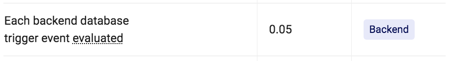

  1. Running the action shows evaluation of conditions (those conditions that are empty and do not exist so should not need to be evaluated)
Nowhere in the Bubble manual is there a reference to either conditions that do not exist, needing to be evaluated and therefore are charged, nor is there a section that details how recurring workflows are charged.
Based on the public details available, I would have expected to be charged only for the below plus the return of a individual data request and the data in terms of bytes…so something like 0.95 WUs, if conditions that do not exist even need to be evaluated, which they shouldn’t, so in reality, maybe 0.90 WUs, but not the 2.46 WUs the metrics show as having been charged.

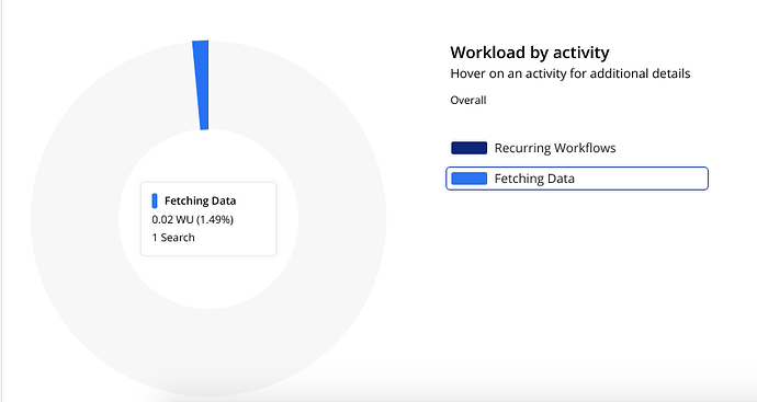

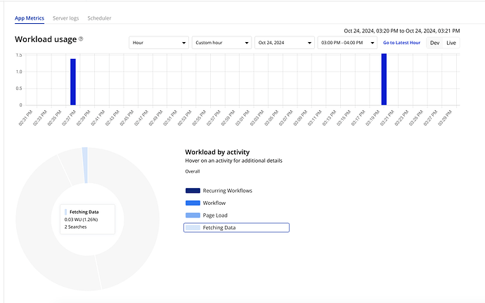

Had to submit a bug report about this, as testing again today, I see another issue, which is that one first day of testing was charged only for 1 search, but on second day of testing was charged for 2 searches, even though nothing in the setup was changed.
I couldn’t imagine why it needed to fetch data two times on the second day of testing since it only needs to retrieve the current user at the time the recurring WF is set, or why it needed to search two times if the first day it only needed to search 1, although it could be that on first day of testing the chart was broken into two different bars, while on second day is was a single bar, so maybe the first day, the 2 searches were just split between the two bars…either way, still confused on why the seemingly overcharged amounts, and why there needs to be two searches to find the single item of current user in the one single place it is used as a dynamic expression…maybe we are charged for when we set the recurring WF and when the recurring WF runs?

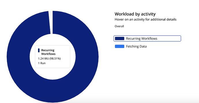

This is what the WUs metrics show after the first run (ie: when the event has to schedule itself again)

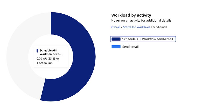

Also, Did you test if scheduling the workflow itself cost less? Because this avoid Bubble to check how many recurring event are scheduled already…

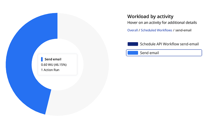

When running recurring backend workflows for the same functionality of a recurring event the cost is for the action itself of the send email, the action of schedule backend workflow and the adding to the scheduler…so total of 1.3 WUs as to be expected as it is all clearly labeled properly, and all in the cost sheet.
The very first run of the backend workflow setup is 2.0 WUs because there is the cost of running the action to schedule and the adding to the scheduler (total of 0.7 WUs) plus the 1.30 WUs for the sending of email, scheduling of backend workflow and adding to scheduler.
