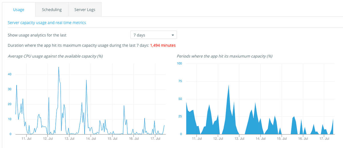

Pepperidge Farms Remembers :frowning:
https://forum.bubble.io/t/announcing-a-new-pricing-and-the-ability-to-buy-server-capacity/
