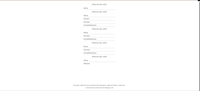

3 tiered Repeating Groups

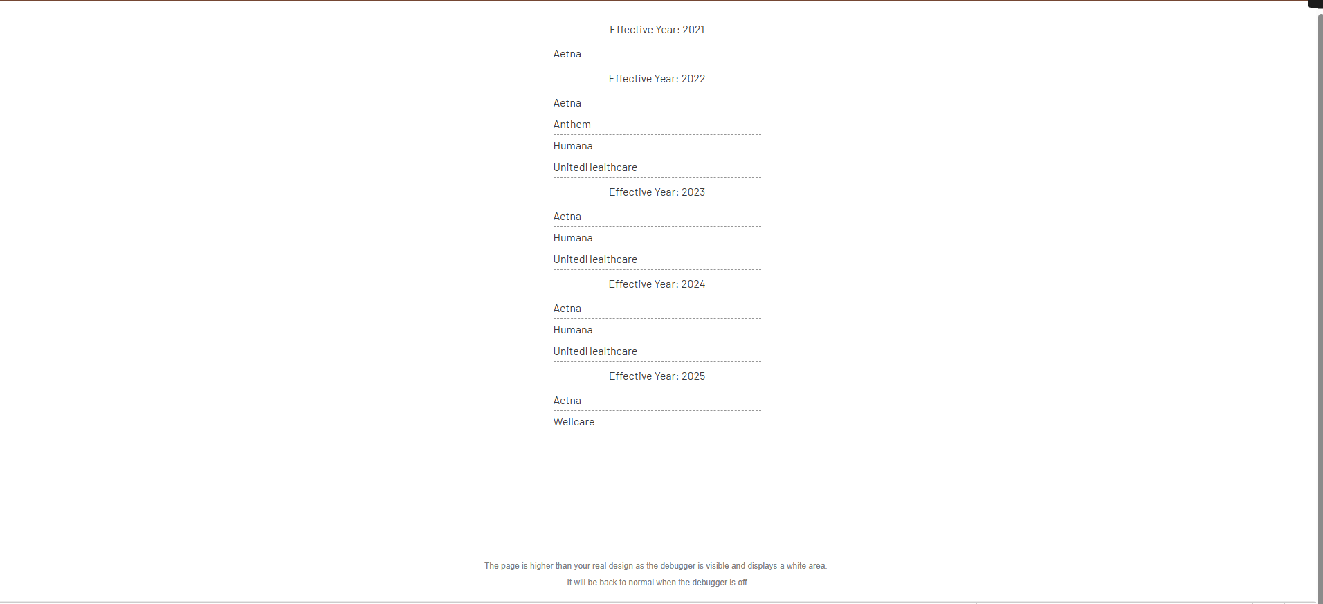

I’m trying to take a JSON sent through API and grouped by Year, Carrier, Product and display the information in 3 nested repeating groups. The top repeating group separates the data by year, then within each year the data is separated by Carrier using another repeating group and referencing the parent cells year (see screenshot).
Where I’m having trouble is the third set of data, products, which should be filtered by the parent cells carrier and the grandparent cells year. I tried setting a state on the carrier repeating group, but it isn’t possible to set this state via a workflow. I’m guessing because it’s a nested repeating group.

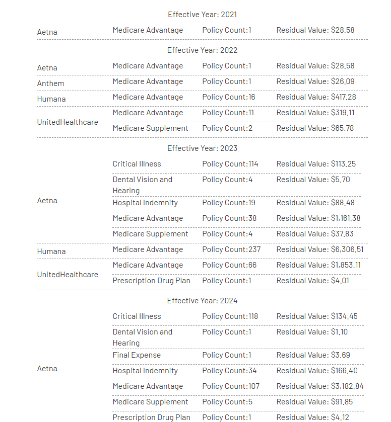

Thanks for your input. I decided to restructure the JSON coming from xano so that it better aligns with the final product on the front end.
