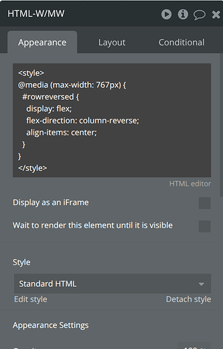

But, I just use code for now:
The max width can be adjusted.
Screen recording 2025-07-22 1.15.35 PM
I use ID #rowreverse.
Works good. Just need to make sure the parent item the group is in isn’t full width.

Didn’t know about this, this is brillaint! Will use! Thanks for sharing!

That’s actually not a best practice for reversing the column order.
The code is to reverse the order.
Yes - my answer is just for changing the layout to column. Not for reversing.
Ok gotcha.
The topic of the thread was reversing the order for mobile etc.
