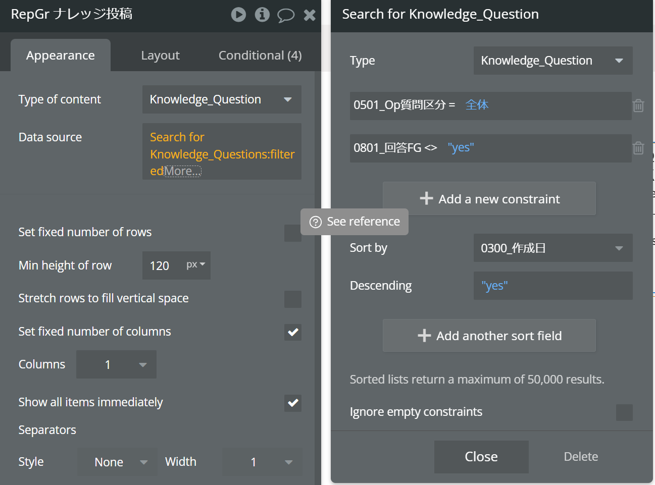

Currently, I have created a database called “Knowledge_Question” and call “Knowledge_Question” from there with “Do a search for”.
I then use “filtered” to control the data displayed depending on the search conditions.
While I’m running this, I receive a request from a client saying, “The list screen is displaying slowly, so I would like you to improve the speed.”
How can we improve the speed of “Do a search for”?

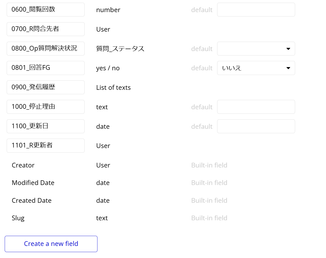

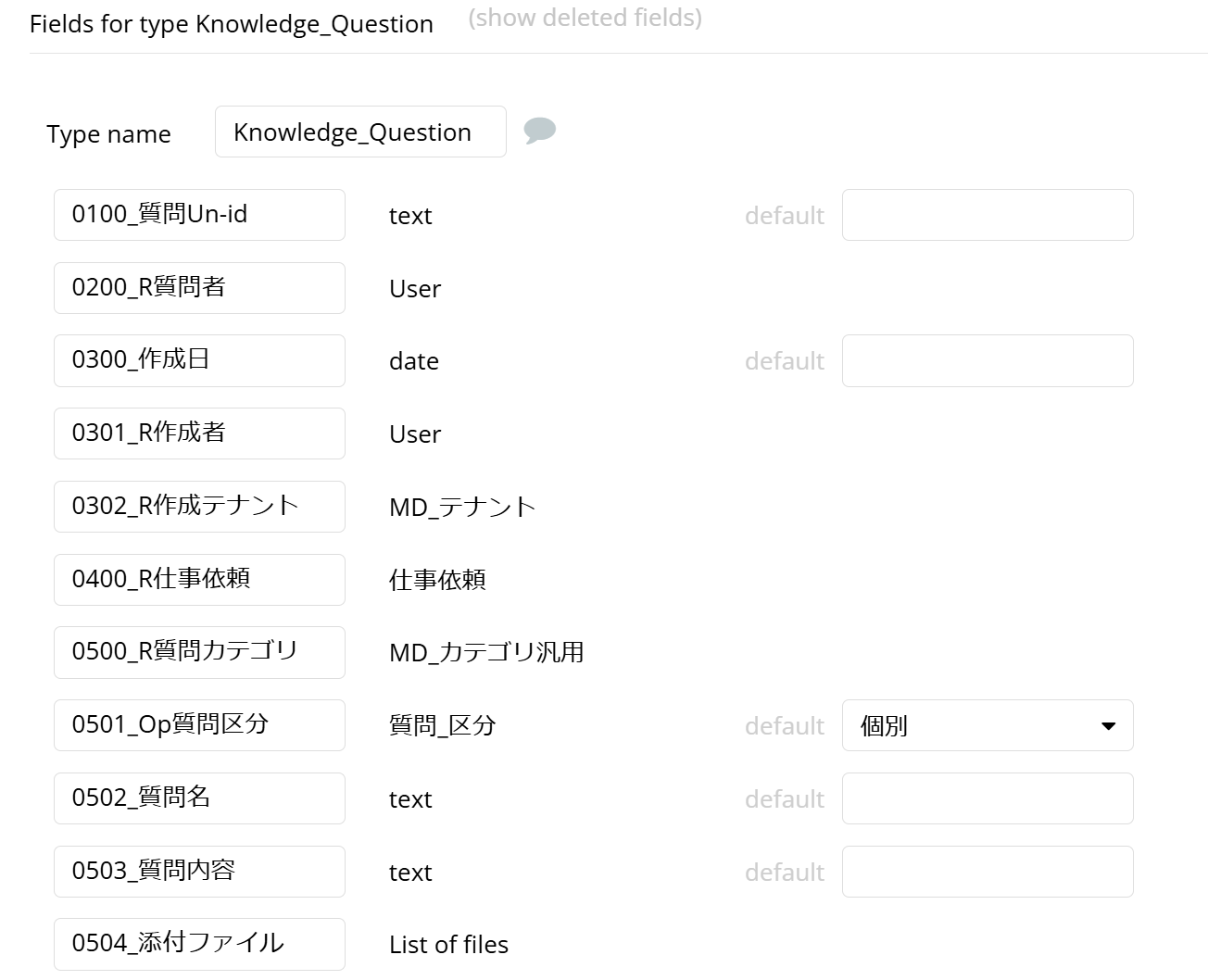

“Knowledge_Question” Fields1
“Knowledge_Question” Fields2

“Knowledge_Question” Do a search for

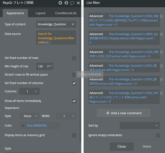

“Knowledge_Question” Do a search for filtered
“Knowledge_Question” Conditinal
Advanced filters are performed wholly client side, which is at least one reason it would be slow. What are they filtering for?

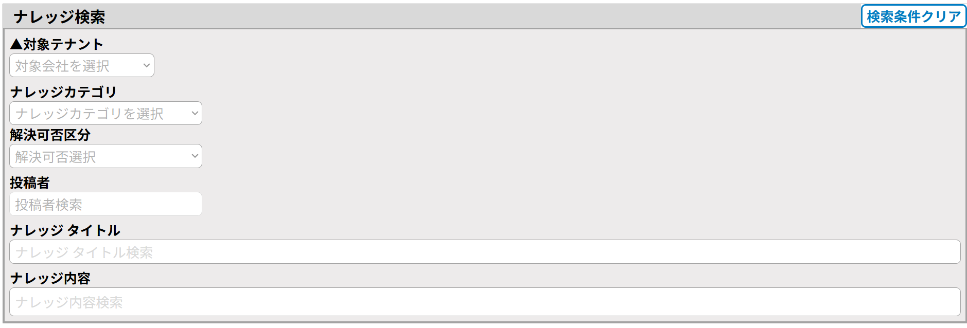

We use filtered to make this search possible.
From the top,
Target tenant
Knowledge category
Solution possibility classification
Poster
Knowledge title
Knowledge content
Are you not able to add them as constraints in ‘Do a search for’?
Make sure you’re caching/storing the data first before applying filters/queries. Otherwise, it’ll run slow (runs each filter as requested multiple times, rather than querying the same data source again).
When adding it as a constraint for ‘Do a search for’, you can only create a conditional expression such as “when XX and XX”,
so I want to create a conditional expression such as “when XX or XX”, so I’m using filter.
Where should I check to ensure that it is caching/saving data?
You can use a merged search as an OR condition (search with condition 1:merged with search with condition 2)
If you merge, it will become “Search for XXs merged with Search for XXs”, and you will have to use ‘Do a search for’ multiple times, so won’t that make processing even heavier?
Backend search (using constraints) is more performant. Forcing heavy client side filtering will kill browser performance for your users.
What exactly does back-end search do?
I meant using constraints in your “Search for”.
