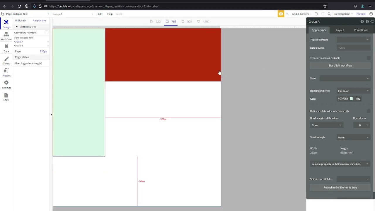

This is now finally possible with the new responsive engine. It’s still in Beta. But soon it will be available. So what is available. When a group is hidden and it’s in a row then it will horizontal collapse. It does not work for a text element and probably also not for other elements except for groups. But you have to test that.
I finally got a peak at the new responsive engine and it looks like it’s going to be magical. I had a short freakout moment on my repeating groups, luckily I duplicated the page and was able to revert back with a little switcharooing. I look forward to diving into it. If anyone is reading this, bubble offers to duplicate the page. DO IT. It doesn’t switch all pages.
It’s already available and has been for ages, but it’s called collapse height, which actually just removes both width and height.
