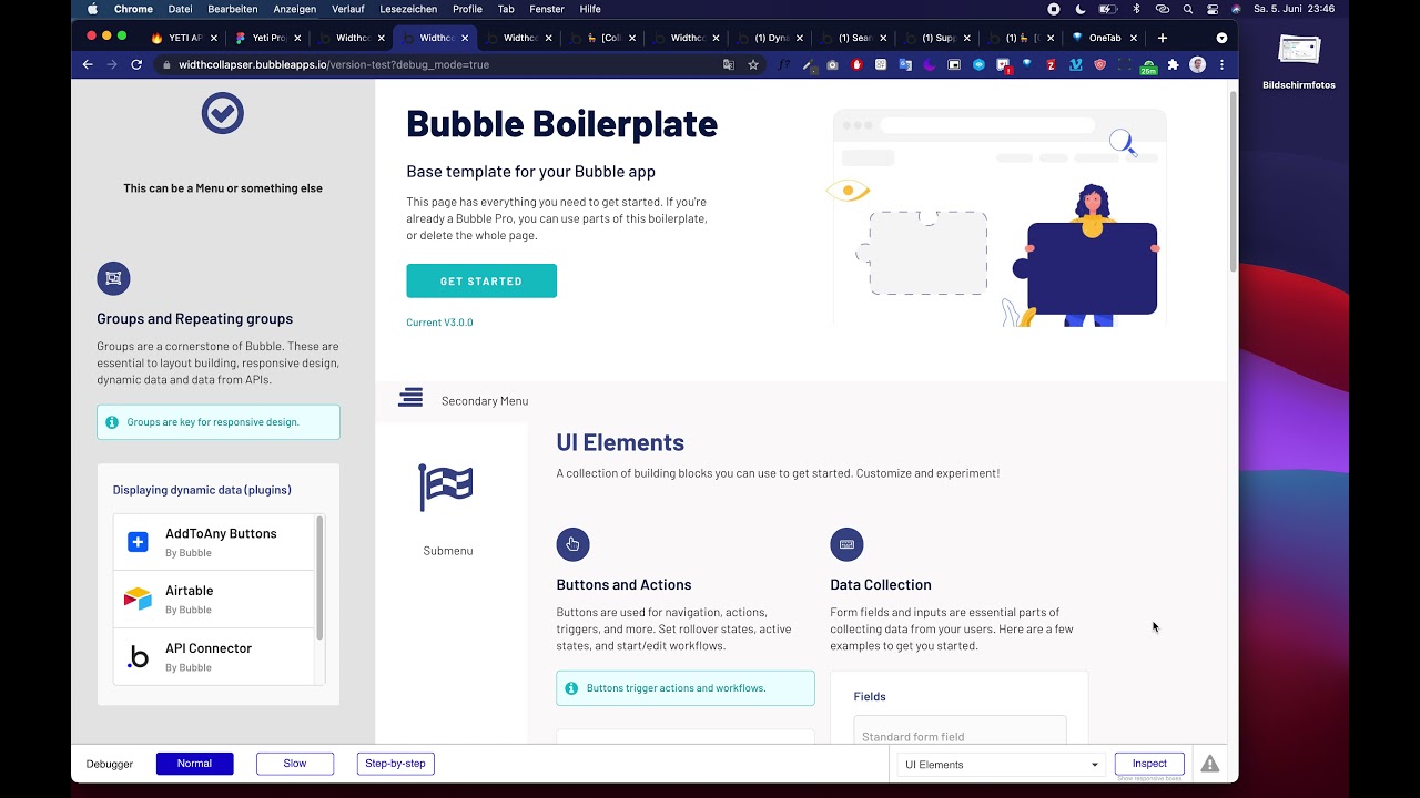

Here a screenshot from my new tool i want to build with bubble:
Main and Submenu Visible
Submenu Visible and Menu Small
Menu Small and Submenu Hidden
How can we do this in bubble?

Just make a floater, and when the floater is open, make the content box (left or right) have a conditional border or about 200 px or so (whatever your width of your menu is).
When you hit that toggle, show the border.
To make it look better, add animation to it via transitions.
Play with that for a day and you’ll figure it out.

This could really work - when you start resizing your browser window this even works perfectly with responsiveness - anyone has an idea how to trigger the responsive engine on bubble via workflow, css, jq or js?
Btw: This only works when the Border is shown when the page is loading - thats why it makes the small jump in page load. If i do not load it directly when the page is loaded - it does not work with the responsive engine.

I like how you treat it on mobile but basically i want the collapse of the sidemenu to have more space - this basically works like you see in the video - the question is how can i trigger the responsive editor without changing my browser size per hand - then everything would work fine.
Link to Example Video:

Most plugins i tried slide the left site and stay with the main content out of browser - i want the content to change in responsiveness when the menu slides in - but this only works if i change my browser size by hand like you see in the video above.
If you want to check out how i did it check out my editor link.
Any CSS trick to change the size by hand so the responsive enginge tracks again?
