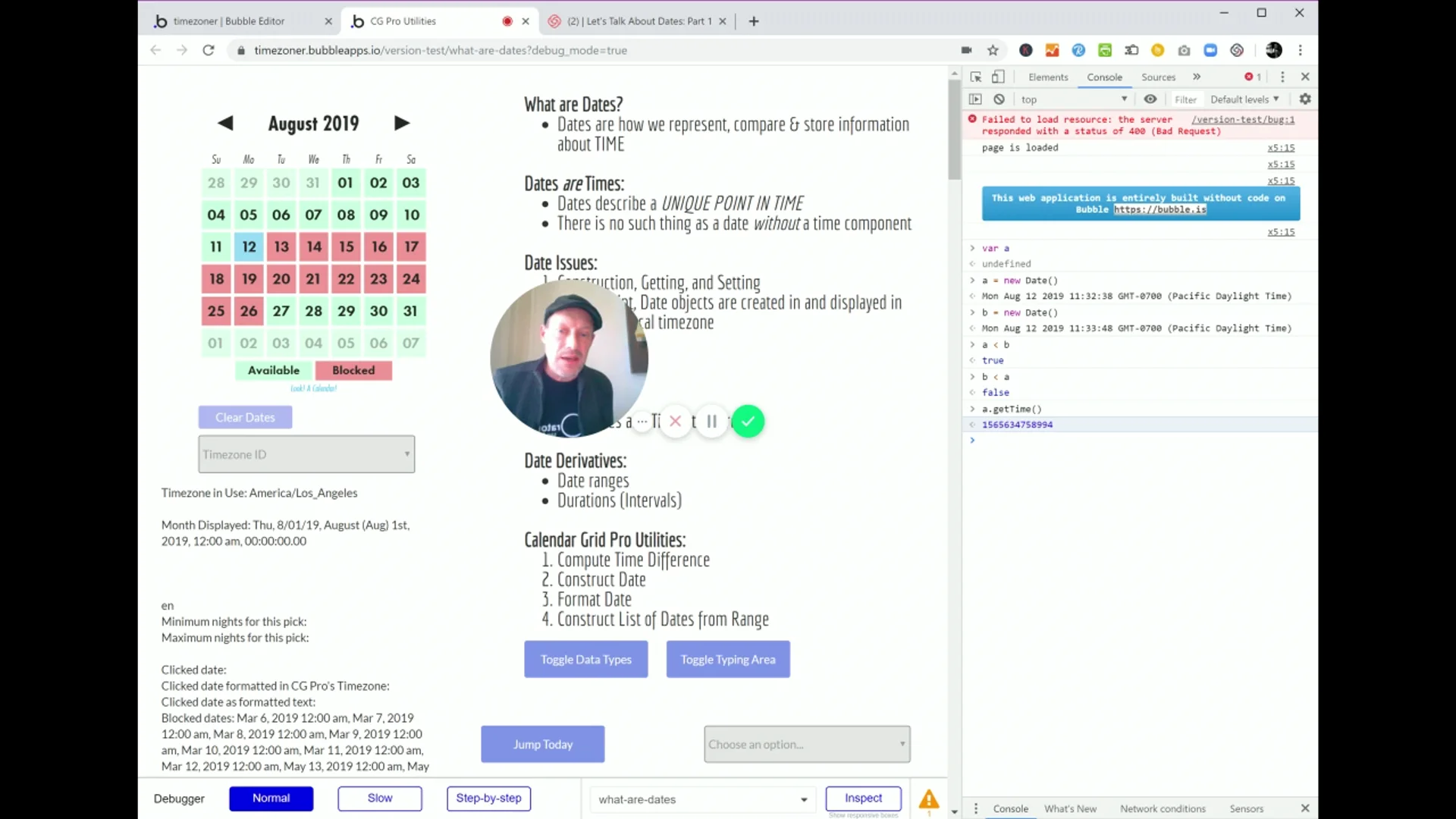

But all of the above probably isn’t helpful unless you understand a few other things about dates and I have a good overview here:
While all of this is fascinating stuff, I talk about date formatting at about the 13 minute mark.
