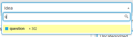

Add a dropdown element like the one used on Discourse
I would love an element like this that shows the items, but allows me to filter by typing.
I recommend the select2 library. “Select2 gives you a customizable select box with support for searching, tagging, remote data sets, infinite scrolling, and many other highly used options.”
